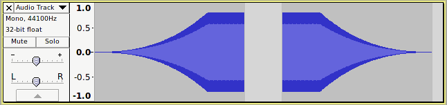

I’ve called this plug-in “Adjustable Fade” (think “adjustable spanner” - a tool that can be adjusted to fit the job in hand).
It has 5 presets that can fade-in from silence to unity gain or fade-out from unity gain to silence.
The presets are:
  • Linear: A linear fade like the standard Audacity Fade effect.
  • Logarithmic: A logarithmic fade similar to using the Envelope Tool.

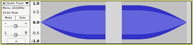

  • Eq Power +3 dB: A 1/4 cycle Sine curve (+3 dB higher at the mid-fade position than a linear fade, suitable for “equal power” cross-fades)
  • Sine ‘S’ Curve: A raised sine/cosine curve that has an “S” (bell) shape.
  • Legacy Curve +3 dB: Square root of a linear ramp - the same as the old Cross Fade In/Out
When a preset is selected, the sliders do nothing (but sadly cannot be grayed out)
There are also 2 “custom” fades:

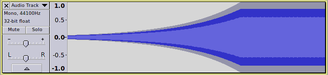

  • Custom Curve: A simple curve that may be “flexed” so that the mid fade level is higher or lower than the mid-fade level of a linear fade. The main use of this custom curve type is to allow a fade from/to silence to be “contoured” to the required attack or decay characteristics.
  • Custom ‘S’ Curve: A “double” curve based on the “Sine ‘S’ Curve”. The main purpose of this fade is to provide smooth transitions from one gain level to another. By applying this type of fade sequentially to sections of a track, the level may be raised / lowered as required in a manner that would require dozens of envelope points to achieve.
When either of the custom curves are selected, the slider controls are active.
  • Fade Direction: choice “Fade Up” or “Fade Down”
Slider Controls:
As Nyquist plug-ins do not have logarithmic sliders, -100 dB is taken to mean absolute silence.
  • Maximum Gain (dB): (0 to +50 dB - default 0 dB) Sets the maximum amount of amplification (the “loud” end of the fade).
  • Minimum Gain (dB): (-100 to 0 dB - default -100 dB) Sets the minimum amount of amplification (the “quiet” end of the fade).
  • Curve (+/- 1): (default 0) This is a similar idea to the “curve control” found on DJ mixing desks. It affects the shape of both Custom fade types.
  • Custom Curve: When set at 0 the fade shape is linear. When increased to a positive value, the mid-point level of the curve is increased. When set to a negative value, the curve becomes flexed the other way like a logarithmic curve.
    • Custom ‘S’ Curve: When set at 0 the fade shape is the same as the “Sine ‘S’ Curve”. When increased to a positive value, the mid-point level of the curve is increased until the curve becomes entirely “convex”. When set to a negative value, the mid-curve level is decreased so that it is at a low level for longer.
To allow greater flexibility for “advanced” users, the slider controls will accept values outside of the slider range without restriction.
This fade plug-in provides a great deal of power and flexibility that is absent from the current Audacity effects. The “Legacy Curve” provides backward compatibility for anyone that liked the old Cross Fade In / Out effects, and the presets offer a good selection of quick and easy “standard” fade types.

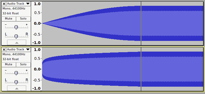

I haven’t done testing in detail yet. I deliberately did not read your explanation of the controls beforehand. It took me 10 minutes until I realised you had to select a “Custom” curve to even use this for the feature request of doing a partial fade. I can make a partial log fade (I believe) in Envelope Tool. Why not in this plug-in? Once again, we seem not to be providing what has been asked for?
When I finally worked out that you have to use a custom shape to do a partial fade, I then cannot set the “Maximum” or “Minimum” slider to negative or positive values respectively without typing. Hmm. I would argue per the above that even if we had % units we could assume most users wouldn’t go outside 0 to 100%. Where the units are dB, not being able to retain a negative value for “Maximum” really seems restrictive.
I was almost about to question if we even needed the “Fade Direction” control. I found that initially confusing, allied with a “Maximum” and “Minimum” control. For my partial fade usage, sliders for Left Gain and Right Gain would be much easier. The big downside of that would be that for the non-default fade direction, you would have to move two sliders, which is probably unacceptable.

A “logarithmic fade” is not "one thing. Consider the following fade shapes, they are both of a logarithmic “type” but sound very different:

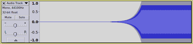

Similarly, these “convex” shapes sound very different:

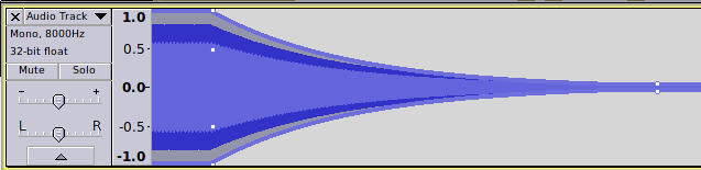

The above fade is actually an “exponential” decay. (Exponential is the inverse of logarithmic).
The source of this confusion is that the fade occurs against a logarithmic scale, but the actual curve that is produced is exponential.

How can curves that bend this way:
be clearly distinguished from curves that bend this way:
Is that example wrongly described in the Manual?
Is the problematic description due to it being a fade out, or to something else?
Is there no “standard” for the shape description, according to the type of scale being used to view?
