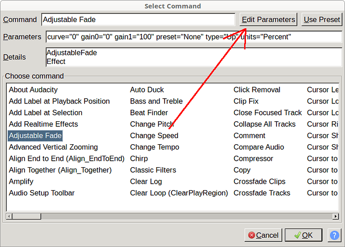

Final question: can I set logarithmic fade out instead of Factory Defaults?
FadeOut:Use_Preset=“”
Instead of “FadeOut”, use “AdjustableFade”.
Click the “Edit Parameters” button to set the options that you want.
and end up with a macro similar to this:
SelectTime:End="0.2" RelativeTo="ProjectEnd" Start="0"
AdjustableFade:curve="0" gain0="0" gain1="100" preset="LogarithmicOut" type="Up" units="Percent"
ExportWav:
