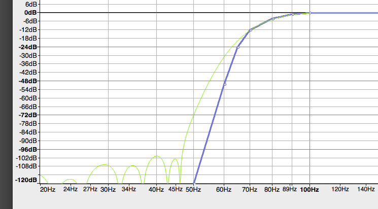

You know you’re not limited to the default horizontal size of the display, right? You can grab one edge of the window and pull. Then you can push the whole thing off the screen and do it again. You can get super accuracy that way without programming or development.
There is one problem with super accuracy. The sound system may not follow you.
This is a pulled and expanded display of the audiobook low rolloff filter.
See that lumpy green line. That’s what the filter is really doing. It’s not following the surgically correct black curve.
