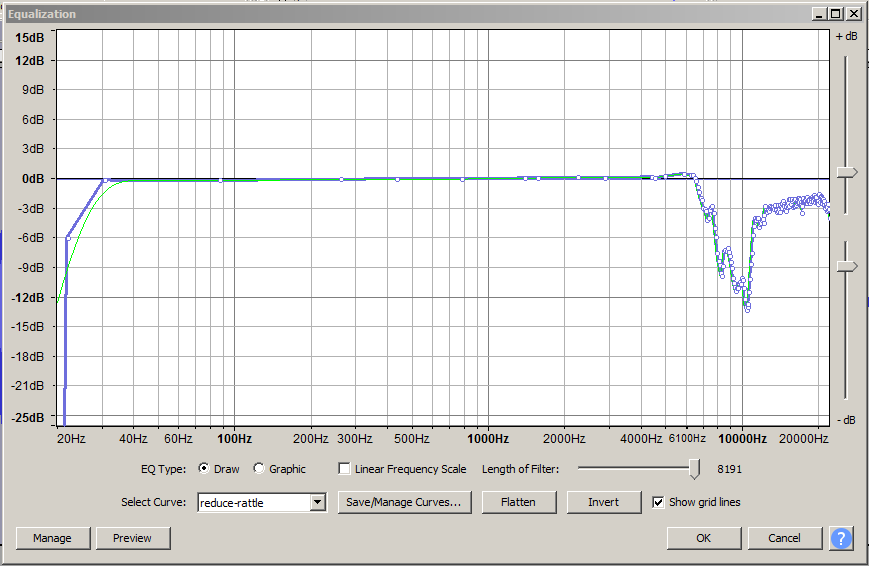

On second thoughts, I think the rattle is mechanical, being generated in the microphone, as it’s faintly on the unprocessed audio. Lowering the pitch is bringing it down from 12kHz-14kHz where it’s barely audible, to 10kHz-12kHz where it’s subjectively louder. Then the treble-boost makes the rattle even more conspicuous.
So the rattle originates in the mic, but is being made conspicuous by pitch-shift down, and treble boost.

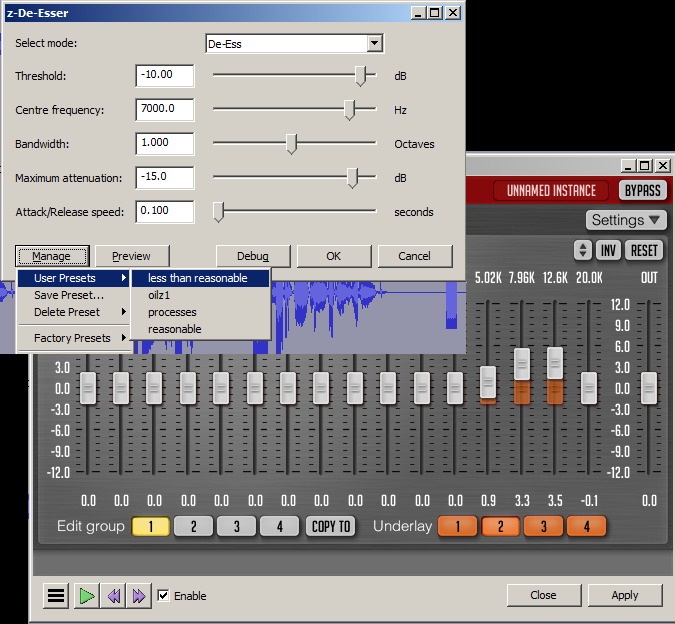

#1 & #2 there is too much de-essing : the volume dips noticeably on sibilance and those parts sound muffled.
The de-esser threshold set to low for that “essential items” audio.

Whatever effects were applied here, rattle-reduction EQ should be inserted after that.
[definitively not before “change pitch”].

Ok, thanks, I’ll put rattle reduction at the end of the chain.

The pattern of sibilance is now too complicated to be corrected by Steve’s de-esser, which just has 1 band. Paul-L’s De-Esser can have dozens of bands, 5 will do …
Paul-L’s De-Esser should only be used on mono, as it will add weird effect on stereo/pseudostereo.
Rather than use two de-essers in your chain, just use precision one : Paul-L’s.

EQ remove rattle ← should this be done before normalize, even first?
I think the rattle-reduction EQ was based on audio you had pitch-shifted, if so then it must come after “change pitch”.

That sounds quite good, no rattle on that one, but needs more de-ess IMO
More frequency bands will do it , but that means longer processing-time …
alternatively leave the settings on Paul-L as is, & add-on Steve’s DeEsser, (on “reasonable” settings), to the existing chain, which will be quicker than increasing from 5 to 20 bands on Paul-L, but the results are less precise …
I’m not suggesting you use the Paul-L de-esser twice, but that you use it once with a slightly lower threshold so it removes more.
Basically lower the de-esser threshold until you’ve gone too far, then back it up by say 3dB from the “too far” setting.
That’s how I set the de-esser threshold.
I’m pretty sure I don’t have the sensitivity to these frequencies to make a good assessment. So I tried -28 in audio-excerpt1, and -29 in audio-excerpt2 attached. Do either of these sound better, or do you think more is required?
Both -28, -29 are quite acceptable, but I would still apply a bit more DeEss.
If I apply -26 to your -29 it still manages to shave-off more sibilance …
The hardware & wetware you have will determine the extent of the upper frequencies you can hear.
Ok, thanks. Running the de-esser twice would mean many many hours processing, which I would like to avoid since there is a fair amount of video work to do as well. Is there a formula or way to determine what applying -26 to the -29 amounts to, such as just do -30 once?
