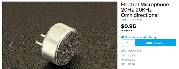

Nowhere does it push the size of the capsule. One of the ways to make a condenser microphone affordable is to use a tiny, pre-baked electret element instead of a full-on inch or 25mm diaphragm. Radio Shack used to sell those for a couple of bucks for making your own microphone.
Though not all miniature electret capsules are equal. It is possible to get then with 20 - 20 kHz frequency response and 80 dB SNR, and they still only cost a few dollars, but for good performance you also need high quality, low noise components to power the mic and drive the output signal.
A decent mic lead will usually cost over $10. To make a complete microphone with a retail price around $25, you have to cut a lot of corners.
