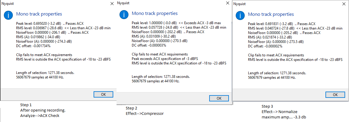

Hi Koz,
I just tried to reproduce your fix and I still failed.
Audio Compressor
– Select the whole clip or show by clicking just above MUTE.
– Effect > Normalize: [X]Remove DC, [X]Normalize to -3.5 > OK
– Effect > Compressor: Thresh -20, Floor -40, Ratio 2:1, Attack 0.2, Release 1.0, > OK

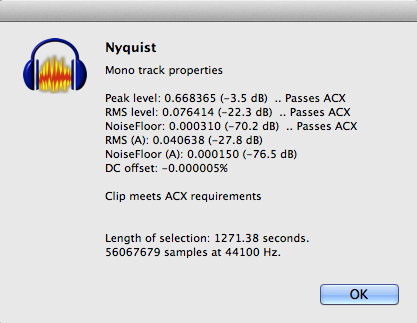

No, I didn’t. And RMS (loudness) isn’t the only bad number. In my correction, the noise is -70dB which is expected and rational. The -207dB noise reading from your correction is not. The only reason that number passes ACX Noise is a quirk in ACX-Check. The way it thinks, any number quieter than -60 passes whether or not it’s rational.

Hi Koz,
I just found page 2 of this post.
I downloaded the same file just as you suggested.
I ran these effects as follows:
Audio Compressor
I see that Length of selection are the same… etc… Interesting that results are different. Your thought?

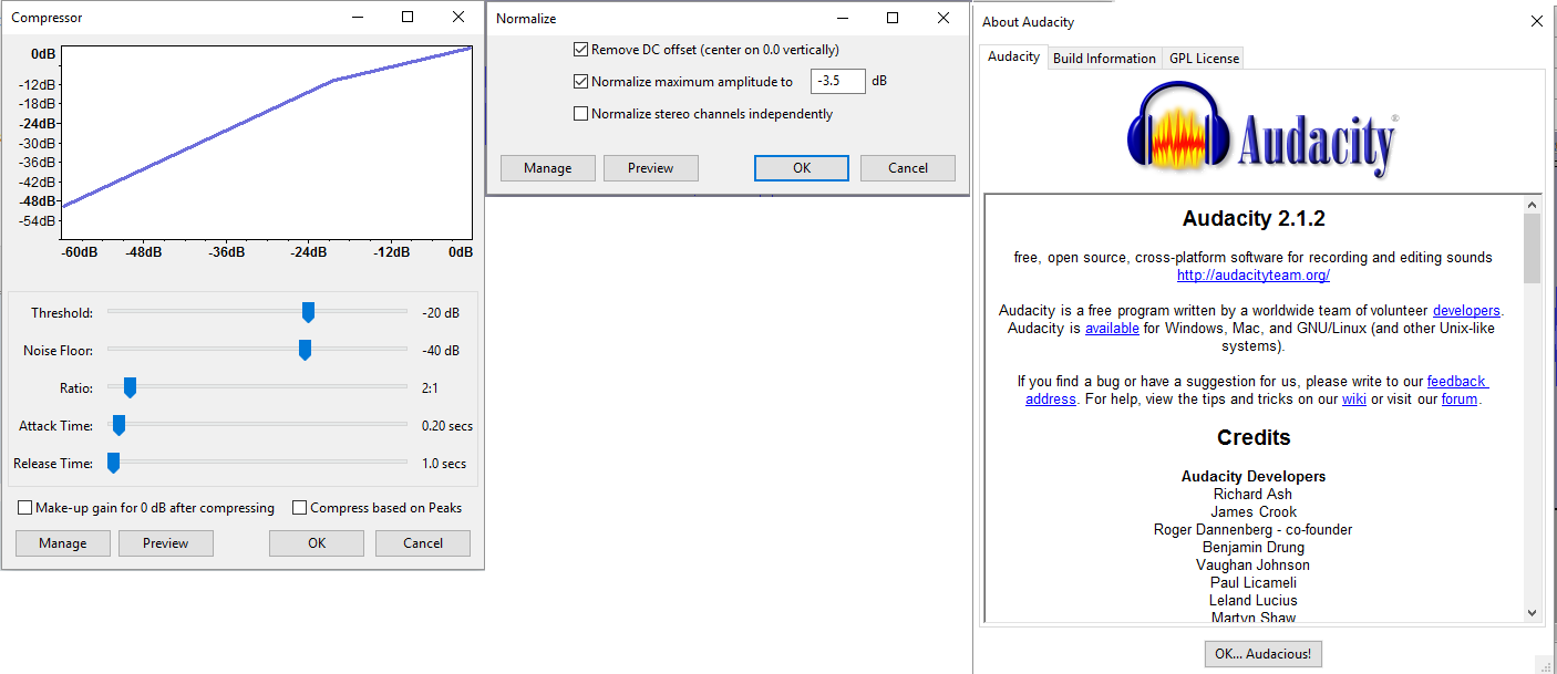

Are you using Audacity 2.1.2?
I need to read over that again and I’m running out of Sunday in California.
As we go.
Hi Koz,
Yes Audacity 2.1.2 and the settings for the effects below.
Thank you, Laura

Open the DB Chapter 1 Edited.wav file you got from the download and Analyze > ACX-Check. I got the attached panel. I know of no reason they should be different.

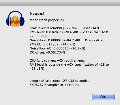

Hi Koz,
Yes I get the same stats as you per the following:
So do I have the same check boxes as you as I have indicated below?
Thank you, Laura
You apply Normalize to -3.5 and remove DC and the blue waves get very slightly smaller.
Our compressors are the same. When I apply compression, the blue waves get very much smaller and the sticking up parts around 10 seconds almost vanish. (attached).
Then I applied Normalize again…and now mine fails, too. Son of a…!@#$%&
