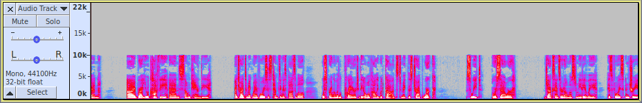

Yes the preview is relatively low quality (high compression).
I can’t tell exactly what they have done, or what the exact “kbps” is, but it is probably fairly low kbps. We can see that frequencies above 10 kHz are absent:

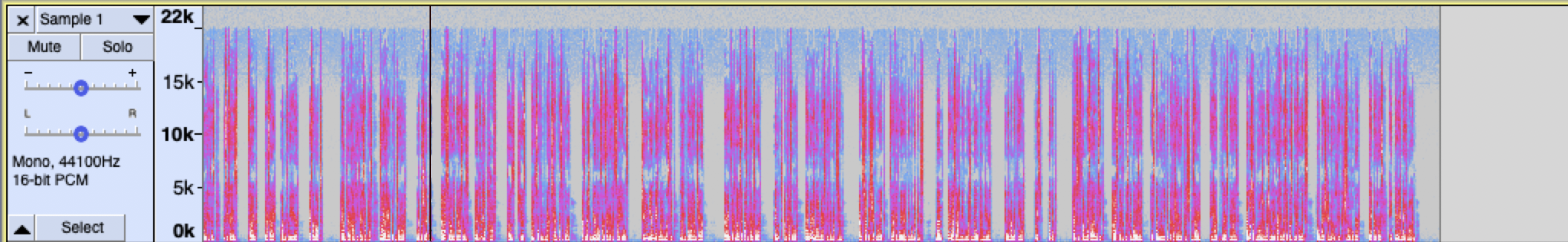

Ah, I see. Right. Assuming I have the settings correct on my spectrogram preview, the original file does go much higher.
Does anyone have any thoughts on what I can do to preserve this quality so ACX doesn’t lower it too much? I know plenty of other narrators manage to get top quality content out (though perhaps their studio’s are higher quality as well), so I’m sure there’s something I can do, I just don’t know what…
