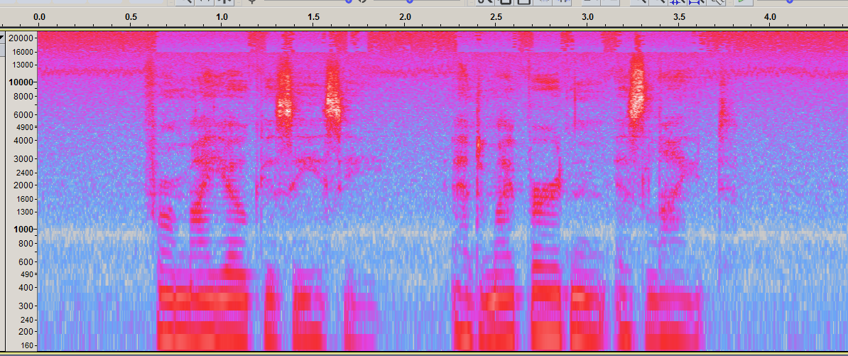

It look electrical: the noise above 16kHz is attenuated when the person is speaking,
& there is virtually no noise at 900Hz …
I noticed that odd sound signature. Noisy microphones or microphone interfaces tend to be “rain in the trees” sound without lumps and bumps in the tones. It’s also possible this is computer fan noise—a computer is warming up after a long time in use and deciding to cool itself. I have a machine which works like that. A half-hour into heavy use and I can hear a low-volume rushing whistle as the fans kick in.
