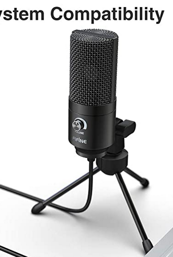

I have a Fifine USB microphone; it was $45 (pic attached); so in hindsight I don’t doubt it’s the issue!
I’ve ordered an Audio-Technica ATR2100X-USB that should be delivered soon. Do you think that an upgrade in mic will help solve this issue?

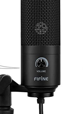

You see that round thing behind the grill? That’s the part that catches your voice. That’s the “front”.
So set up the microphone so it’s upright…
… and then pile books underneath it so the “front” is even with your lips and about a Hawaiian shaka away.
This kind of microphone doesn’t care if it’s right-side up or not.
