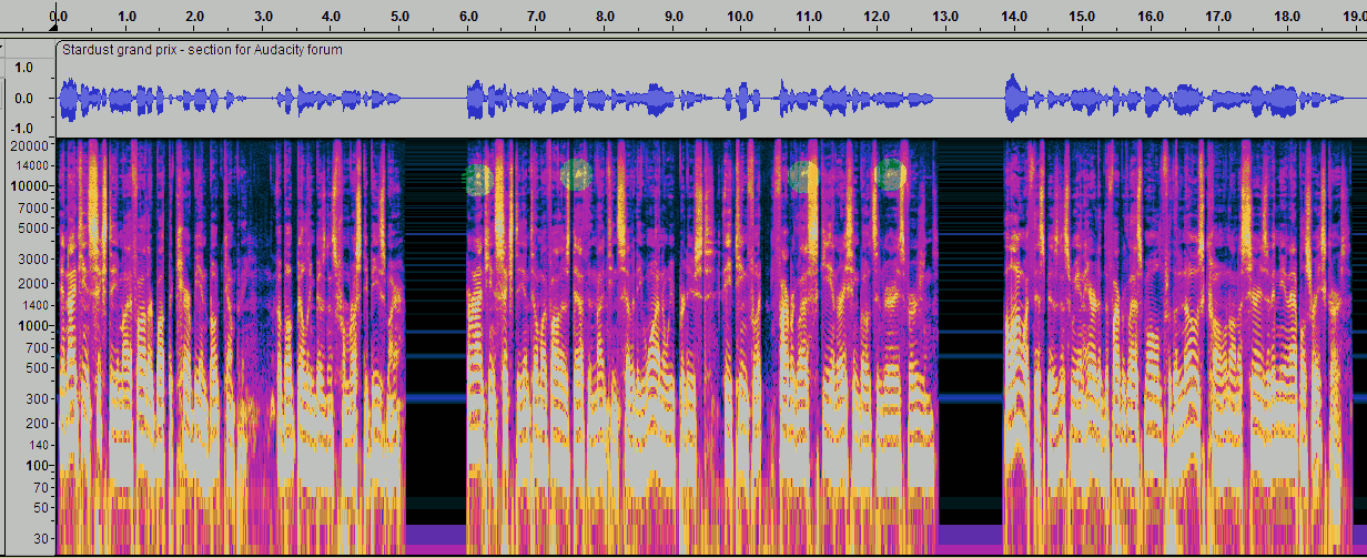

That beep in the middle is me boosting the Room Tone-Background Noise between words. What’s supposed to happen is spring rain in the trees shshshsh or fffffffff pink noise. That’s natural microphone or recording noises. What you have is digital radiation, screen crosstalk, or software trash.
It’s low enough volume that nobody cares, don’t worry about it, but it really shouldn’t be there. I did a test once where I tried to read a script from a tablet. The tablet made noises in the performance.

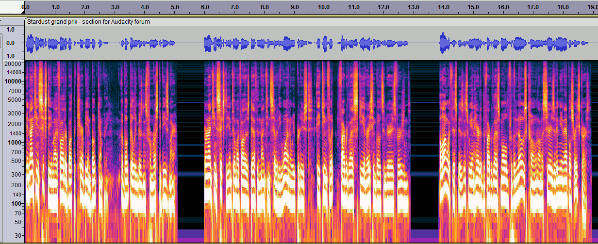

The room tone you’ve added is not typical, it looks like a ~3ms sample looped, so it has harmonics (the horizontal parallel lines on spectrogram) rather than noise, which is random, (without repetition) .
Your mic has resonance between 11kHz & 13kHz, this adds a gritty harsh sound.

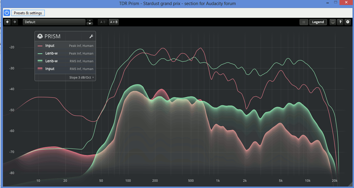

The EQ sounds a bit muffled: lacks mids & highs … TDR Prism | Tokyo Dawn Records (free plugin)
and the compression looks odd: each phrase starts loud, and I can hear levels pumping.

TDR Prism is a free VST3 plugin that works in Audcaity3
You can load a reference track into TDR Prism to compare with yours, see … https://youtu.be/tMzQVOfNVbo?&t=467, but you have to manually EQ your track to match.
[ There are TDR plugin$ which automatically match EQ ].
TDR Prism does not come with any reference tracks. You could use an audiobook read by a male as a reference, or this noise which matches a generic male voice …

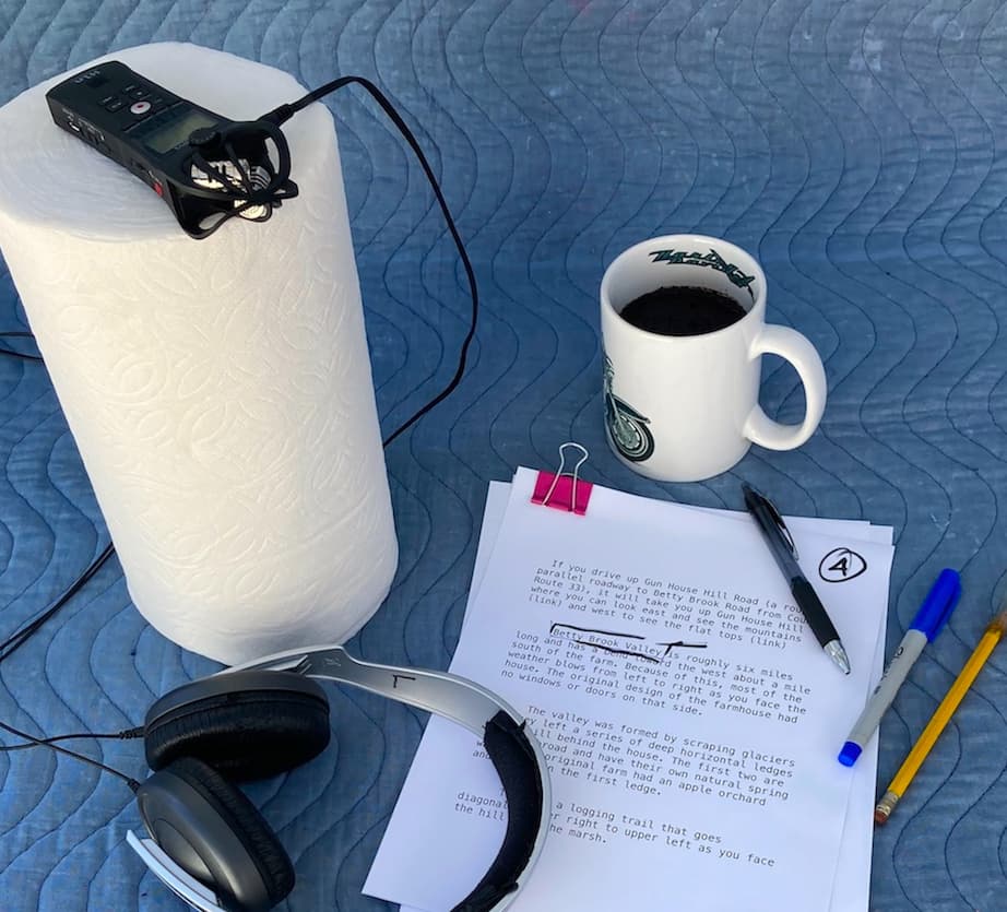

I don’t know that I have a voice sample on that. It’s a Zoom H1n standalone recorder. That picture was taken in my outside studio. That lighting is coming from the white building next door.
