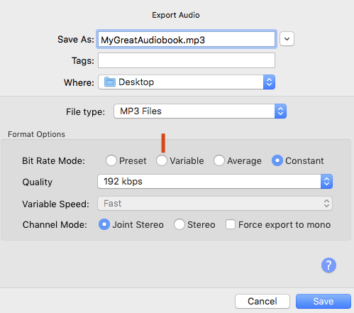

When you export your MP3 from Audacity, pay attention to the MP3 settings. (see: https://manual.audacityteam.org/man/mp3_export_options.html)
  • Select “Constant” as the “Bit rate mode”.
  • Set “Quality” to 192
Did you set the MP3 export options?
Variable Bit Rate is a setting in the Audacity export panel (red bar).
The above is an example of how you would Export for ACX submission. You can use Force Mono, ACX likes Mono submissions, but I’m not a fan. Make Mono in your Audacity edit master and then the Channel Mode options don’t mean anything.
