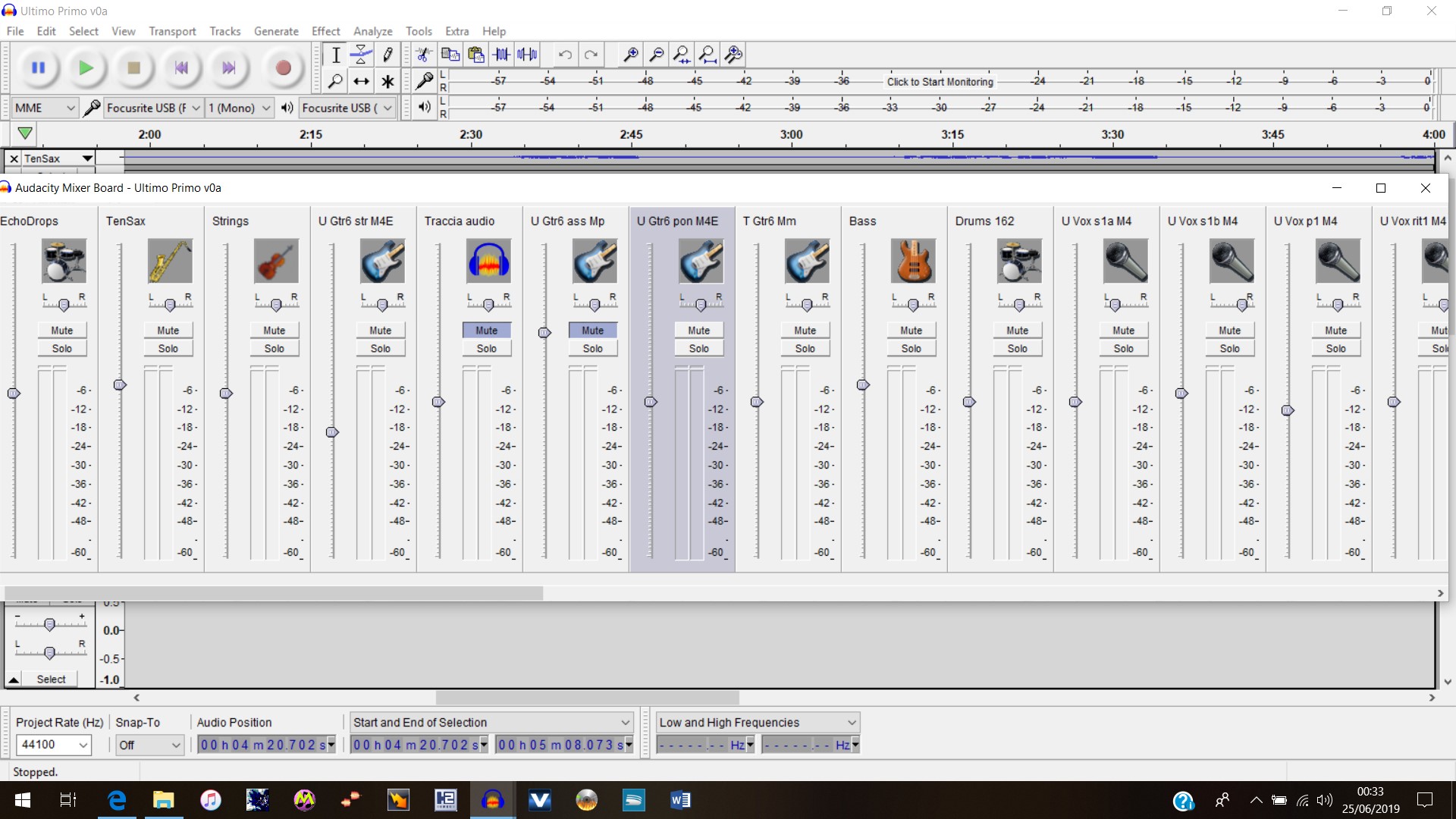

in Mixer we have: Gain slider, PAN slider, and mute/solo buttons.
I’d like to have:
1 - “Add Effect” = a button/menu, that behaves like “Effect Menu”
2 - “View Effect” = a button/menu, that is similar to “Hystory”, but with the list of the effetcs triggered for the actual track:
EffectName1; Parameter1:Value1, Parameter2;Value2, etc
EffectName2; Parameter1:Value1, Parameter2;Value2, etc
etc

My request is about the possibility to activate an effect on a whole track directly from the mixer (where there are already the “commands” for volume, PAN and mute/solo that are activable for the whole track) and then review what I’ve done, in terms of the list of effects with their respective parameters.
I think I’ve used the wrong term…
to "activate " I meant applying an effect on the track in the same way to select the effect from the menu, not activating it in real time.
You can select a track for an effect to be applied to, by clicking on the track icon in the Mixer Board.
By default the track icon is the Audacity logo, unless the track name matches one of the defined instrument names (see: https://manual.audacityteam.org/man/mixer_board.html)
I doubt there is any will to duplicate the main Audacity window menus at the top of the Mixer Board, so you still need to use the main Audacity menus, or custom shortcuts, to select the effect.
