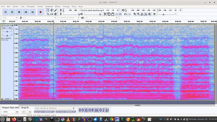

If I look at a tone recorded to VHS and captured, the frequency will jump around a little, not staying constant, and does not follow any recognizable pattern.
Here is a screenshot of a note in Spectrum view, and shows the inconstant tone due to variation in tape speed.
Anybody have good ideas on how to recreate this accurately?
