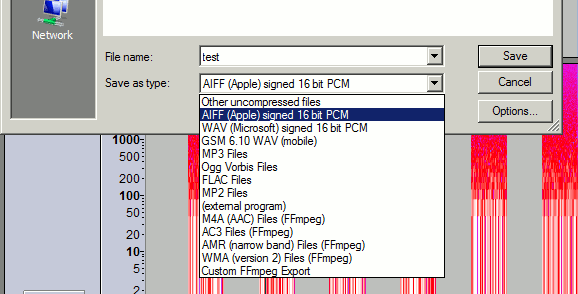

Me no speak Mac , but If AIFF is not shown on the drop down menu shown below ( when exporting audio from Audacity) …
Then I think you need to install something called FFmpeg into Audacity to be able to export any audio from Audacity in the AIFF format …http://manual.audacityteam.org/o/man/faq_installation_and_plug_ins.html#[u]How_do_I_download_and_install_the_FFmpeg_Import.2FExport_Library.3F[/u]
[ IIRC AIFF is native to Audacity : you shouldn’t have to install FFmpeg to export in that format ]
