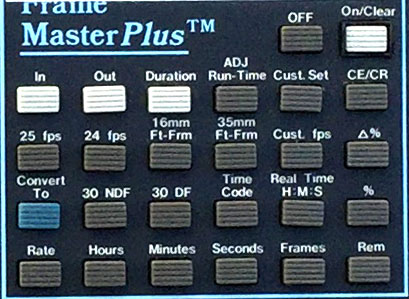

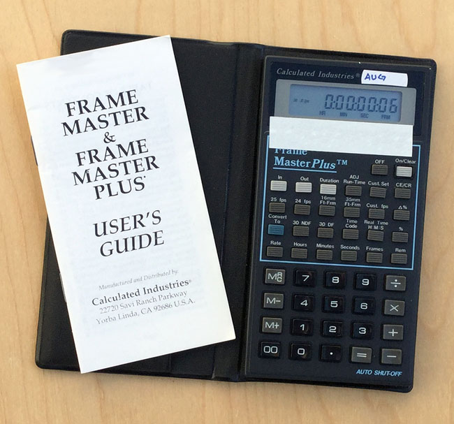

Attached a valuable tool in this quest.
Apparently, there was a FrameMaster II.
http://mathcs.albion.edu/~mbollman/CI/FrameMaster2.htm
