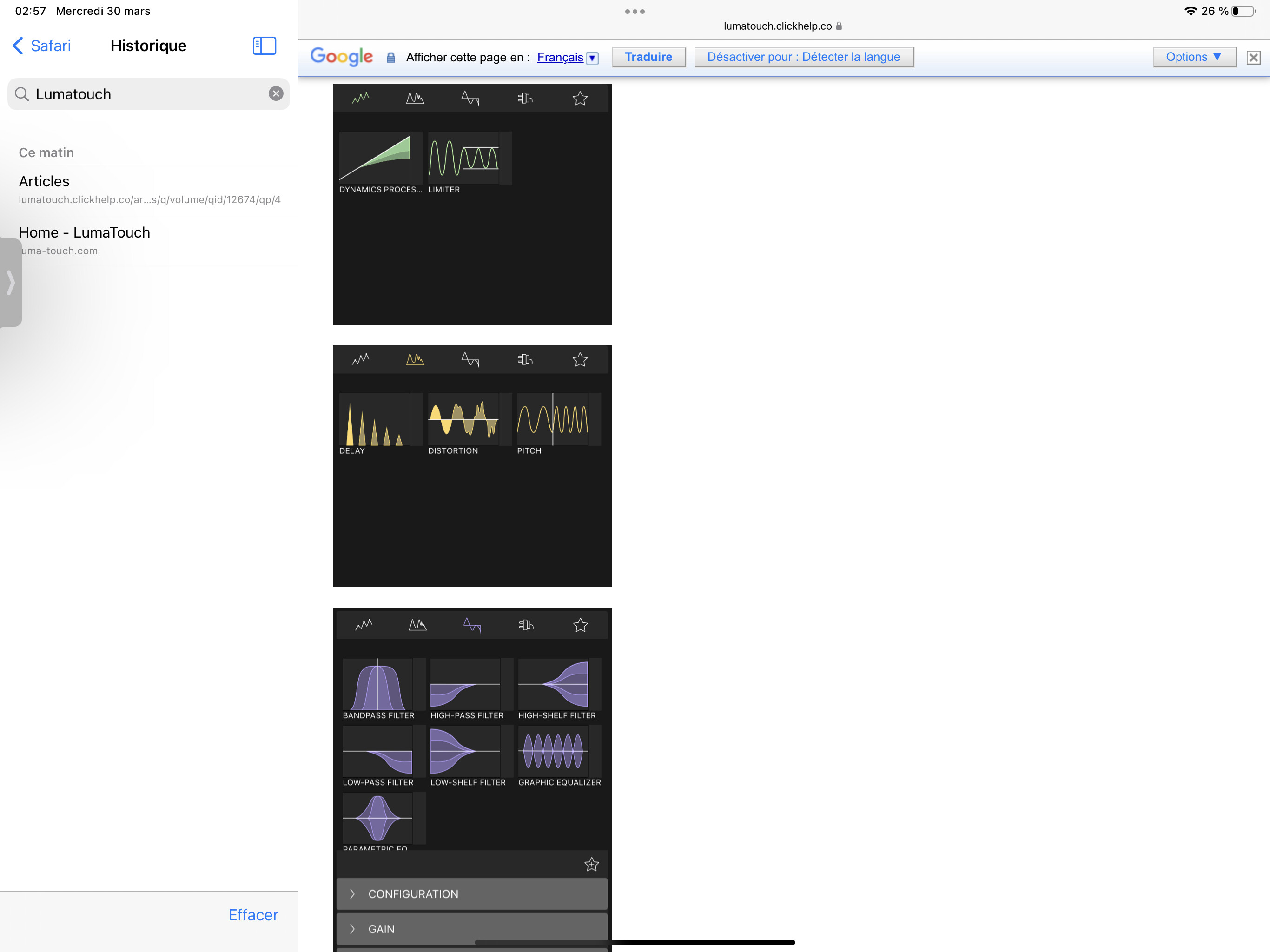

Sorry, I have not a question about Audacity but I need help for another sound app and maybe you could help.
It is Lumafusion for Ipad. An exhaustive video editor.
I have an echo issue on a video and I would like to remove it.
There is a lot of sound options on Lumafusion and I don’t know wich one could help for that.
Maybe there is an Audacity option to do that.
To know wich one could perhaps help me to find an equivalent on Lumafusion…
The technical words are surely the same.
Maybe you could say : what about the Lumafusion forum ?
I already ask the question but they have no answer
They are really good for all the video issues with a lot of videos but the sound is a very specific world.
Here is a screen shot with some of the options.
Thanks
Audacity can’t help with echoes.
Either.
Echoes are a special case where the performer’s voice (as an example) hits the microphone more than once. There is no key or tag to tell Audacity which is the main voice and which is the echo. You are, in effect, asking the software to remove the voice from itself.
This is why we urge, very strongly, to soundproof your room or environment before you try recording your voice.

It depends on the type of echo.
If it’s long, a gate may help, just be careful with the timings or you will start cutting off the ends of wanted dialog.
On the other hand, if it’s a “short” echo, then you’re pretty much stuck with it.
There are plugins that do remove some of the echo, but at a cost, degradation of the audio.
