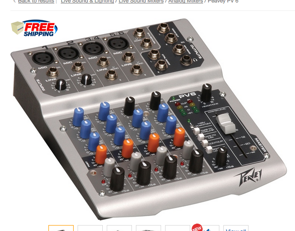

My mixer is a Peavey PV-6, but it will only do four microphones (attached, at the bottom). They were hoping nobody noticed.
http://www.sweetwater.com/store/detail/PV6
Many people make mixers like this. The Behringer units are supposed to be pretty good.
You still need to adapt the 1/8" plug from the microphone to the three-pin XLR sockets along the top of the mixer. From there, it’s adjust levels and mix your brains out.

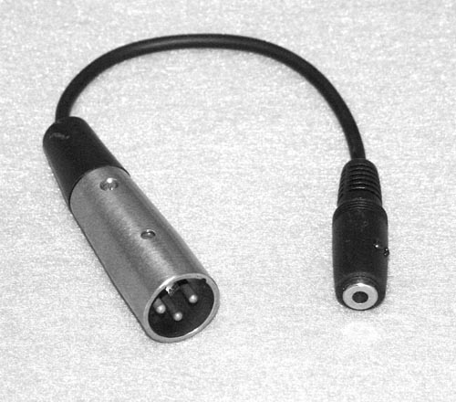

Here you go. Missing puzzle piece.
You can’t buy those. There are adapters that appear to be correct, but the wiring inside is custom. I made those with my tools and soldering iron. The 1/8" female is chopped from a Radio Shack three-to-one headphone adapter. It happens to have the right connections and I can make three adapters out of one purchase.
You plug your lavalier (chest) microphone 1/8" male into that, plug that into any XLR microphone mixer (make sure Phantom Power is turned off) and go.
