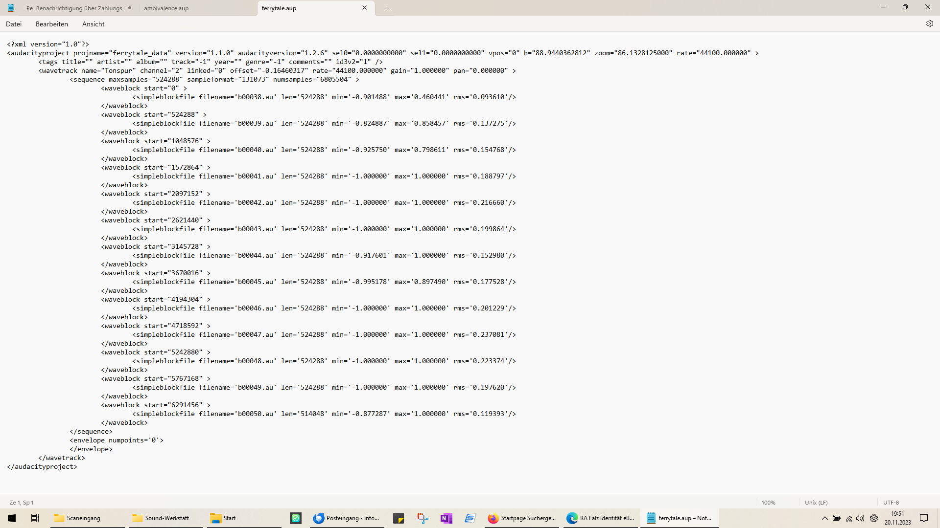

Unfortunately it does not work. Here I send you the screenshot of the aup-file, opened in “Editor”. Maybe you see the solution. :slight_smile:
So I can see that your data directory should be named “ferrytale_data” and your .aup file should be named “ferrytale.aup”. Also, “ferrytale_data” should have a dozen or little .au files buried in nested folders. You can actually see these .au files being itemized within the .aup file. Do they exist ?
