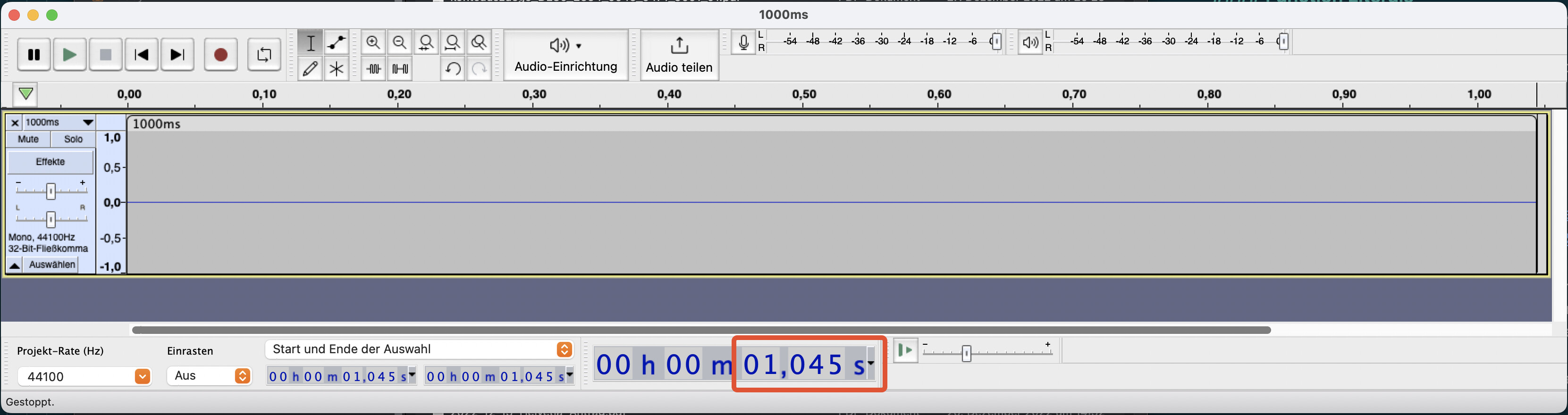

I created a 1000ms MP3 of silence on macOS 13.1 (Ventura) with the following:
ffmpeg -f lavfi -i anullsrc=r=44100:cl=mono -t 1.0 -q:a 9 -acodec libmp3lame 1000ms.mp3
See attached file.
But Audacity shows a 45ms longer duration for the file; see screenshot.
Why is this the case? And what’s now correct? Audacity or the generated MP3? If Audacity is correct, where do the additional 45ms come from?
It’s because the MP3 format does not specify encoder / decoder delay.
When audio is encoded to MP3, it is processed in “frames” (chunks of audio data). The first frame must include the start of the audio, and the final frame must include the end of the audio, but the format does not specify how much delay there is in the first frame before the start of the audio, or how much space there is in the final frame between the end of the audio and the end of the frame. Consequently MP3s have a bit of “padding” at the ends of the file.
From https://en.wikipedia.org/wiki/MP3 :
Encoder/decoder overall delay is not defined, which means there is no official provision for gapless playback. However, some encoders such as LAME can attach additional metadata that will allow players that can handle it to deliver seamless playback.
Some older versions of Audacity used the metadata from LAME to automatically trim off the padding at the ends (you can observe this in Audacity 2.4.2), but in Audacity 3.2.0 the MP3 decoder was changed and this no longer happens, so the padding is still present at the start / end of the track when imported. I logged this as a regression back in October: https://github.com/audacity/audacity/issues/3778
If you need to import MP3s into Audacity without the “padding”, use Max ( https://sbooth.org/Max/ ) to convert the files to AIF, then import those into Audacity.
– Bill
