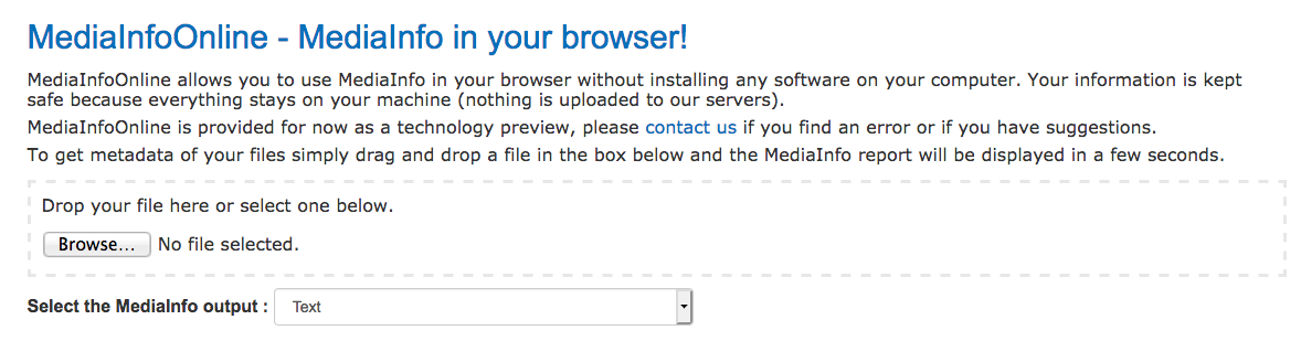

What happened with the MediaInfo tools? We absolutely expect your two sound performances to not match. You can do those locally without shipping sound files around.
Make a short recording, “Testing one two three.” Stop. File > Export WAV (Microsoft) 16bit. Run Media Info in your browser.

Put a file to be inspected on your desktop. Run your browser. Type or paste this in. This is FireFox.
