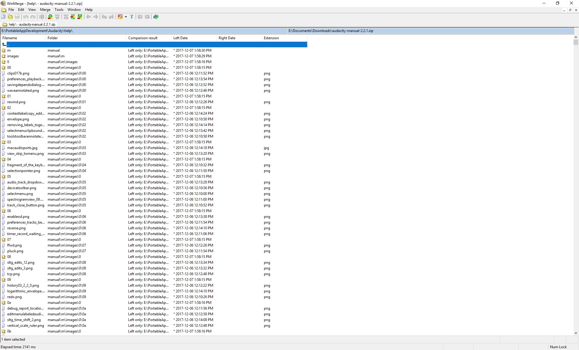

It appears the Audacity 2.2.1 Manual zip file is broken in some way.
When opening inside the zip using 7-Zip, it is possible to see all files as expected, as compared to the same files from the Windows Installer.
However, upon extracting the zip, many of the images, along with what appears to be random folders, do not exist.
When attempting to extract, 7-Zip errors with “Unavailable start of archive, Warning, The archive is open with offset”
I was able to confirm that this did not occur with the 2.2.0 manual zip. It doesn’t look like the RCs had copies of the manual available as a zip, so I can’t confirm between 2.2.0 and 2.2.1 when the error occurred.
Please see the attached log from 7-Zip and comparison from WinMerge below.
