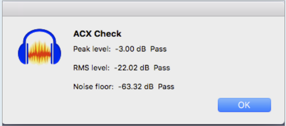

The first analysis is the GB clip just Mastered. Without doing anything but those three gentle effects, you meet ACX no trouble, and with a little elbow room to spare.
But being professionally obsessive, I applied gentle Noise Reduction of the Beast (6-6-6).
That should sound exactly like you and easily meet audiobook standards. If you do this under Audacity 3.0 (or whatever it turns into) it’s two steps. I melted Mastering into one Macro step. That may need to wait until they get the new program sorted.

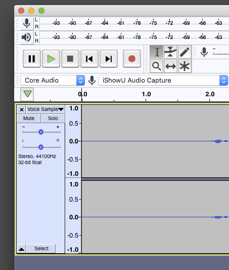

One more. Are you creating stereo tracks for a reason?
There’s no good reason to have Left and Right versions of your voice, unless there’s a client who wants it that way. ACX would just as soon you submitted in mono.
From your stereo track > Drop-Down on the left > Split Stereo to Mono.
[X] delete one track.

Aaaaaaand Voice Sample-USB Direct to Audacity.wav failed.
I just know we’re going to have a really good laugh about this when you figure out what’s going on.
And the DropBox submission passes.

recording to stereo before realizing I should’ve done it in mono
If you’re recording from an H2n I don’t think you have any choice. It’s a stereo microphone and if you force it to mono during the recording, you may get loudness and clipping damage.
There is another way to “convert” from stereo to mono. Tracks > Mix > Mix Stereo down to Mono. That has the advantage of leaving the voice where it is and reducing microphone hiss noise.
The noise reduction is not quite half. Wouldn’t it be a kick if that was the difference between the two tracks. Garage Band is supplying Two-Track Mono and Audacity is presenting Real Stereo. There would be a significant noise difference between those two, but they would look the same.
