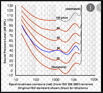

This is a good time to remember Fletcher-Munson. The ear sensitivity isn’t flat over the spectrum. It’s most sensitive to tones around 3000Hz. I call it “Baby Screaming on a Jet” and “Fingernails on Blackboard.” You get the most bang for the buck by processing at these tones.
Thank you very much, I hadn’t actually known about that, and will use this knowledge going forward!
