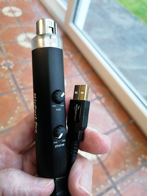

I only see a MicPort Pro 2 and it doesn’t look anything like yours.
Can you post information or how we can find out more?
If you have been recording with the -10dB switch on, changing it may be enough to solve noise.
Here is another view of the gadget.
I got it from the same store that you linked to for the Portabooth, but several years ago now.
I’ll make sure that the -10 setting stays off in future, but I do have 5 hours of audiobook to master and won’t rerecord it now.
