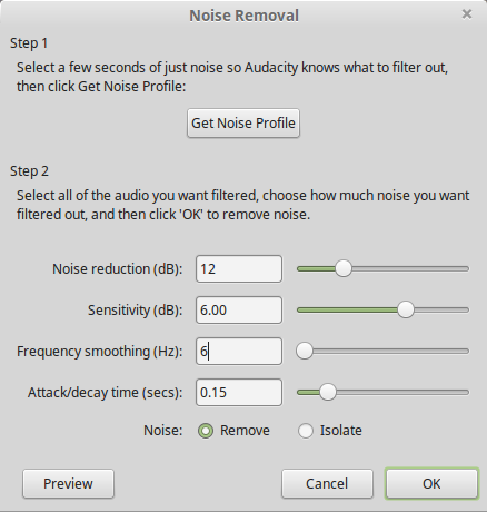

Start with your raw clip and make sure you can duplicate my steps. You have an odd low pitch tone in this recording and the clip won’t pass noise with it in there. It’s not any obvious problem I can think of—it’s not power related. That’s the notch filter step that’s new with this process.

Okay. I am attaching a version of that file which I corrected, following your instructions. There were a couple of points where I wasn’t too sure, as the menu in my copy of Audacity must differ slightly from yours. Here’s a picture of the menu for noise reduction, as I used it.
It still sounds a little tinny to me.

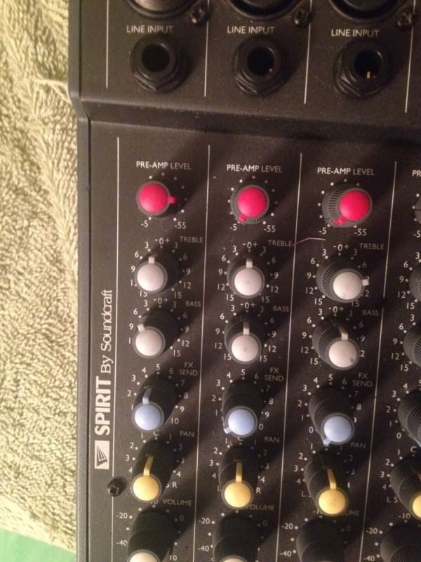

I’m remembering this. I can’t find a graphic big enough so I can read the Folio knob labels and tell you where they should go. Find a link with a picture large enough to clearly read the knobs and post the link. Or post the link to the instruction book or post a picture of the mixer you took with the knobs clearly visible. There’s no shortage of mixer pictures, but they’re all the size of matchbooks and I can’t read them.

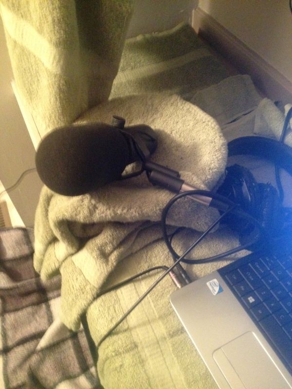

How do you have the microphone suspended or mounted? Do you have a “rubber spider” shock mount for it?
I don’t have a good picture of this. It’s on my list of camera tasks. These will have to do.

Here’s a photo of how our microphone is supported. Under that towel is a stone pestle, we brought up from Mexico. It cradles the mike.

I can tell you where to put the controls if I could see and read the mixer knobs.

I’d kill for a picture of that mixer.

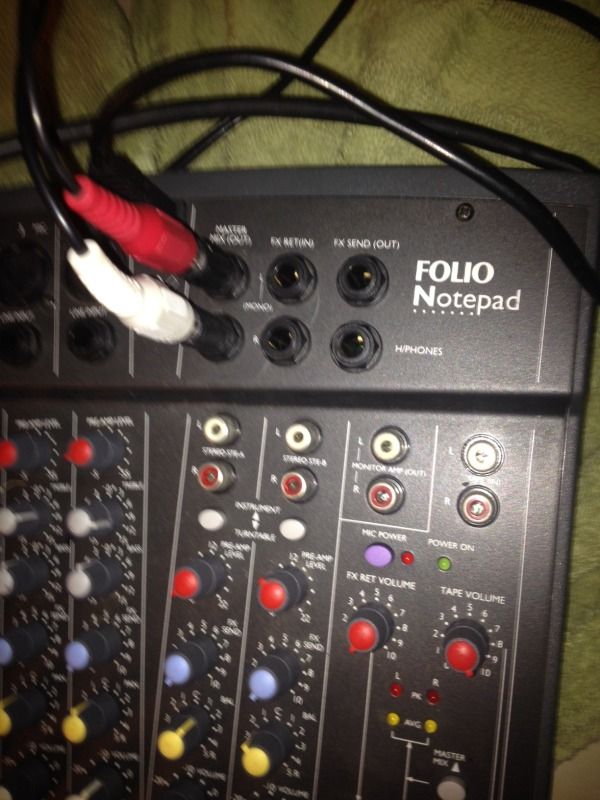

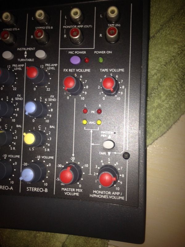

Here are some pictures of the Folio Notepad.

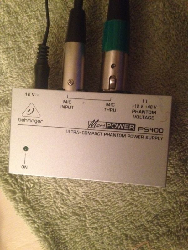

Also, here’s a picture of the phantom power supply.
Connection is thus:
Folio mic jack to MicroPower PS400 “Mic Thru”
“Mic Input” of MicroPower PS400 to Cloudlifter CL-1
From Cloudlifter CL-1 to Shure SM7A mic
Note: it is a Shure SM7A. I understand that there are other Shure mics out there.

The Cloud Lifter is just another 20 dB of gain. It’s good for ribbon mics, if you need it.

Shut down the mixer and the Phantom Power generator. Plug the microphone directly into the mixer. No Lifter and no phantom power. Make sure “Mic Power” is not selected on the mixer and turn it on.
Mixer Settings:
– Preamp level on your microphone at 3:00 o’clock. Turn all the rest of them down as far as they’ll go.
– All the Trebles and Basses across the mixer should be centered at zero.
– All the FX Sends to zero.
– All of the Pans at “C”.
– Volume on your microphone at “0” (around 2:00 o’clock). Turn all of the others to infinity.
Most of that turns off the 4/5 of the mixer you’re not using so it doesn’t contribute noise.
– Mic Power Off.
– Instrument/Turntable buttons should all be Up (Instrument).
– FX RET Volume at zero.
– Tape Volume at zero.
I’m not totally sure what Tape Volume does, but I can try to look it up later. Leave it at zero.
– Master Volume around -10.
– Headphone volume whatever makes you comfortable.
You didn’t take a shot of the upper right. Where do you have the UCA202 plugged in? Is there a Line-Out or a Master-Out?
Right now, with no computer running, it should be possible to speak and get the yellow AVG lights to flash. Plug your headphones into the mixer and it should be possible to hear yourself very clearly. Never run a microphone and speakers in the same room (unless you’re in a rock band).
This is a grand place to stop. Did you get the yellow lights and can you hear yourself in your headphones?

Since we don’t have Audacity or the computer turned on yet, you should plug your 7506s into the mixer. The headphones come with 1/8" plug and a 1/4" adapter, right? You can plug into either socket? So shifting between the computer to the mixer should be no trouble — if you can remember where you put the adapter. Not that I’ve ever done that.

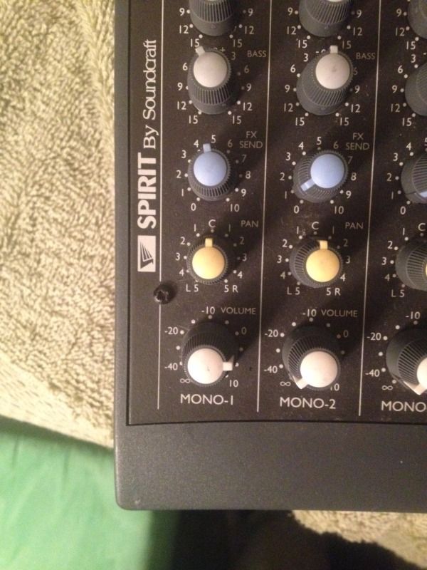

Advance the Headphones Amp control (lower right) and talk. You should hear yourself even if it’s not very strong.
Advance the red Preamp Level (up left) one notch. Advance the white Volume knob at the bottom of that stack (lower left) one notch. Keep watching those yellow lights while you do this and talking. Push the Master Mix Volume (lower right) all the way up. Talk. Any lights yet? your voice in the headphones should be getting louder and louder as you do this.
If there’s still no lights yet, run all three knobs all the way up and get closer and louder at the microphone until you get something. Warn people that you’re going to be yelling. Quick Note: You talk into the end of an SM7, not the side. The SM7 was designed to suppress sounds except the ones coming in from the end (the performer).

This is my mixer with those same three knobs labeled.
The up side of knowing how to run your mixer is then you know how to run most mixers. I got that picture from an ad, I didn’t take it, so the knobs are set wrong, but they’re in roughly the same places yours are.
