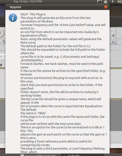

Unfortunately the first two help screens do not fit on a 1366 x 768 screen on Linux due to lines wrapping.

I’m on 800x600 on Linux; I don’t think there we are claiming to support lower resolutions. Two solutions would work on both our systems a) carriage return after 50 characters b) put each paragraph on one long line and let the OS wrap the text.
a) might sometimes look better if there is no objection to white space at the right. On my machine, b) creates lines 1, 2 and 4 with a not too excessive space to right, but line 2 goes to the border so really it doesn’t look good. On another font, the result might be different again. On your system, a) would give you more white space to right; for people at < 800 x 600, a) would give an arbitrary result. I suppose although I don’t like always like how b) turns out on my machine I would suggest b) is probably what we should do. Anyone else?

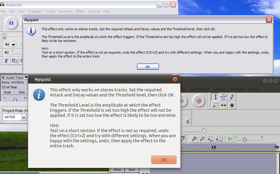

I’m getting auto-wrap at about 71 characters for long text, and at about 50 characters on short messages. Both look fine.
A new paragraph, with one clear line between adjacent paragraphs is produced by two “new lines”. A “new line” can be either “n” or “~%” or a typed new line (line break). Is that the same on Windows and Mac?
I don’t particularly like the look of b) on my machine (1440 X 900). It produces very long lines (approx. 260 characters) which I think are less easy to read than shorter ones, but it still looks better than Steve’s screenshot.
If we used a newline every 50 characters, how many lines could we fit on an 800 X 600 screen?
(I’m reluctant to change my screen resolution to test it, because it takes me ages to get all my desktop icons back where I want them afterward!)
It’s the same on Windows, at any rate.

This is without forced formatting on Linux (Ubuntu) and Windows XP
The screen size for XP is 1360 x 638 (on virtual machine)
The screen size for Ubuntu is 1366 x 768
This is the text if you want to do a like-for-like comparison:
"This effect only works on stereo tracks. Set the required Attack and Decay values and the Threshold level, then click OK.
The Threshold Level is the amplitude at which the effect triggers. If the Threshold is set too high the effect will not be applied. If it is set too low the effect is likely to be too extreme.
Hint:
Test on a short section. If the effect is not as required, undo the effect (Ctrl+Z) and try with different settings. When you are happy with the settings, undo, then apply the effect to the entire track."
