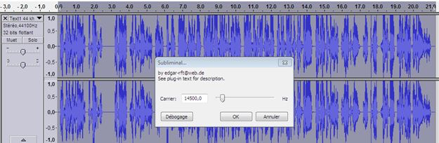

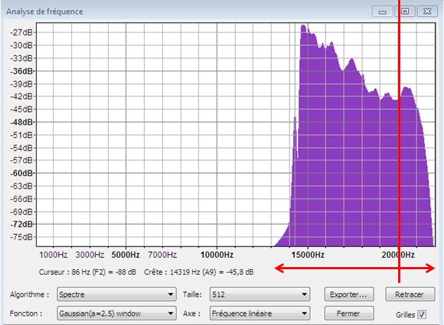

My mp3 player is limited to 20,000 Hz, so how do you generate from an mp3 stereo audio,
a subliminal message with the highest frequency does not exceed 20000 Hz :
I get exceeds 21,000 Hz :
Thanks.
MP3 format is unsuitable for this type of recording. I wrote an explanation of why that is previously in this thread.

please do you can write the complete process of edgar subliminal plug in , how not exeed 20000 hertz , because my record with subliminal effect reach " 21000 hz"
at 44,100 frequency , at 14500 hz in subliminal effect and reach 22000 with sublimal effect at 17500 hz …
the code for nyquist is not good , because the ( spoken words ) affirmations are reduced, decreased sound quality !!!
please help me !!!
in france there is a website " subliminal silencieux " , with a subliminal plug in ( 50 euros ) what is the difference with the edgar plug in ( or subliminal ny )
which doesnt deforme the voice …
THANK FOR YOUR ANSWER :unamused:
The code is good.
The sound quality is poor because for a sample rate of 44100 Hz and a carrier frequency of 17500 Hz, the audio bandwidth is less than 4500 Hz, which is not enough for high quality audio. You will need to use a lower carrier frequency, or a higher sample rate, or a different method for making the voice “silent”.
