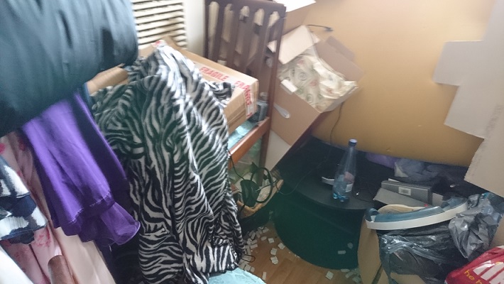

I have put it on some of the piled-up boxes in the store-room

This is awesome - thank you so much. This is my current recording studio, lol. Loads of boxes and a big foam mattress. I’ve added a few more blankety things on the harder stuff (random bits of plywood, stepladder etc.) The mic is hidden - wrapped in the zebra blanket, but I’ve been able to take that off and just sit it underneath since moving the computer out of the room.
I know, I know. Where do I actually sit?!

There are tricks to soundproofing, too. No two opposing flat walls. Echoes happen when the sound bounces repeatedly between walls. If say, the North wall and the East wall are deadened, echoes are killed past the first slap. Throw heavy rugs on the floor and that kills the floor-ceiling bounce. A Yeti and most other microphones with a cardioid (kidney-shaped) pattern will not respond to sound from the rear, so the first wall for consideration is the one behind your head.
I did several good voice recordings in the storage room for a branch of the company. Boxes of paper contracts and manila folders soak up sound and echoes nicely.

Yes, there is a small exterior window. I don’t have a room or closet without any windows. It’s three floors up and to the back of the house, so it was the best I could do. I did have to stop recording occasionally for sirens, next doors dog barking and the odd aeroplane, but it is the quietest room in the house. I have the mic turned away from it, but I will see if I can find an old curtain to put up over it.
Thanks for the tips on the flat walls and floor. I think I will be bringing the spare duvets into use there.
I’m midway between a police station and a hospital, so even with a well-soundproofed room, emergency vehicles are a problem.
You can get a slight advantage with wall hangings by not jamming them against the wall, but leaving a small gap, say inch or two. Drape rods or curtain hanging hardware can be handy here.
