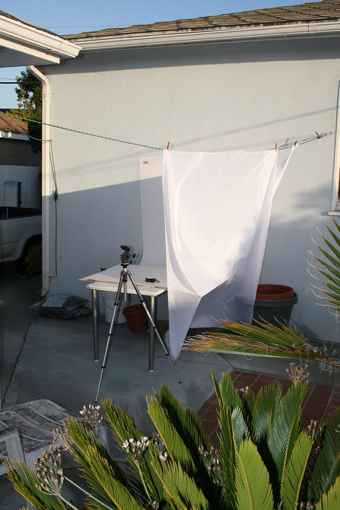

Regarding this picture…
That’s dress material and the lady at the cloth store asked me what I was going to use it for. I finally broke the charade of creating a fabulous wedding dress and admitted I was going to use it as a lighting scrim for photography.
If I had taken that pantyhose to a cashier instead of the Star Trek lane, I probably would have told them it’s for the dog. I’m definitely bookmarking this page. Lots of good info. I’ll post a whole track tonight or tomorrow.
