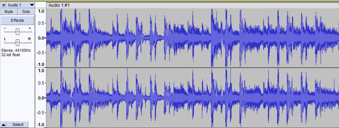

Control-Click on the player > Save Audio As > LRMonoPhase4.mp3.
And as way above, I expect the blue waves to look like this.

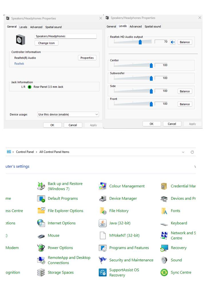

I think to help eliminate sound card problems you should uninstall your “costly” sound card and unplug it completely. Then start up the PC and check the onboard audio Realtek is installed in Device Manager and no Yellow question marks or Red X’s. and check settings in Windows Control panel and check if it works on its own. attached is copy of typical sound card settings…

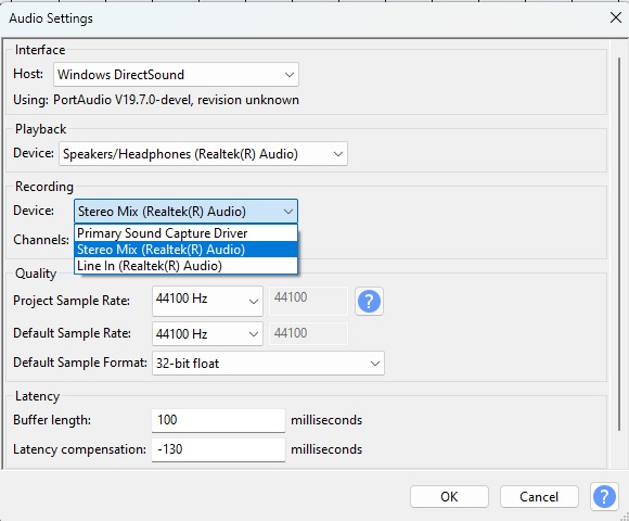

““The problem lies in that Audacity recognizes it as a “recording option” but when I select it in Audacity, AS WELL AS in Windows sound settings, it simply does not record, flat-line.”” … YES, that is correct…You didnt post any of your settings but in windows sound control it is probably Linein or Mic. You are not using Linein or Mic in now. You need to enable “Stereo Mix” in the control panel… look at my settings I posted. You may have to “show Hidden devices” to see it greyed out, but it needs enabled and in my case I have it as default I think. Then when you open Audacity again you will see Stereo Mix listed and click it to make Audacity use it as input. Then Play your file or Youtube, click record and the blue waves move across into the track. and you hear it play at the same time. Your “costly” sound card should work similar when you install it again but may have different names, but I imagine will also need mixer… Also notice sound enhancements in the control panel jpeg in last post is UNTICKED to avoid any filtering etc untill you get it working aand see if you want it.

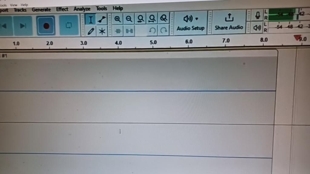

So, basically Realtek works within the Windows framework! Just not in Audacity. I’ve swapped between the two only options on the Realtek ports “line in” & “mic” Windows instantly recognizes it, everything is copacetic in Task Manager, settings, speaker properties… but even toggling between options in Audacity recording and audio settings… well picture speaks a 1,000 words. I was going to post a 15 sec. video, but discovered this forum doesn’t support videos, so hopefully this pic will work. (see attachment). There is some activity on the monitor scale, but not enough to register an actual recording.

Thank you, thank you, thank you…. “Stereo Mix” was totally hidden. It works, however, I’m not sure if the issue with the ASUS Essence sound card would be that simple. Hopefully now that I / We got the Realtek working. I can install and I’ll let you guys know the follow up to that one.

It’s working with both sound devices. As you suggested, setting is “Stereo Mix” and selecting the ASUS as recording device. MME for interface. Did I leave anything out?
