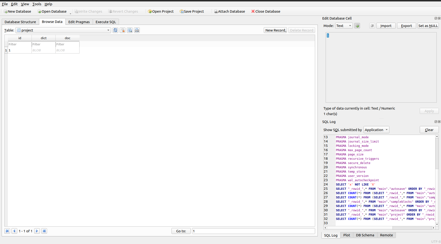

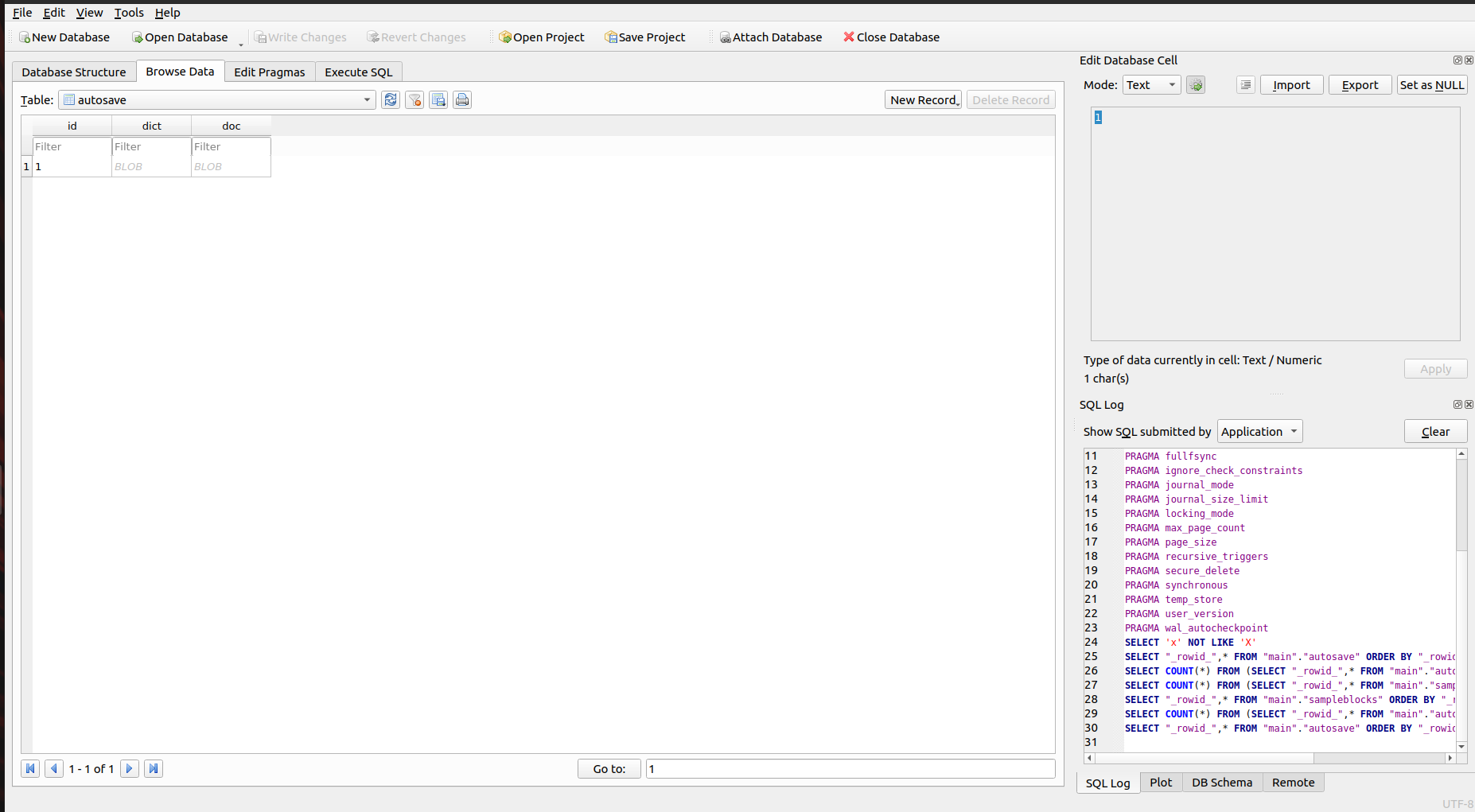

One last idea:
- Open the AUP3 in DB Browser for SQLite in the usual way
- In the “Database Structure” tab, right click on “project” and select “Modify Table”
- In the pop-up window, change the word “project” in the first text box to “unused”
- Click the “OK” button
- In the “Database Structure” tab, right click on “autosave” and select “Modify Table”
- In the pop-up window, change the word “autosave” in the first text box to “project”
- “File menu > Close Database”
Now see if the project will open.

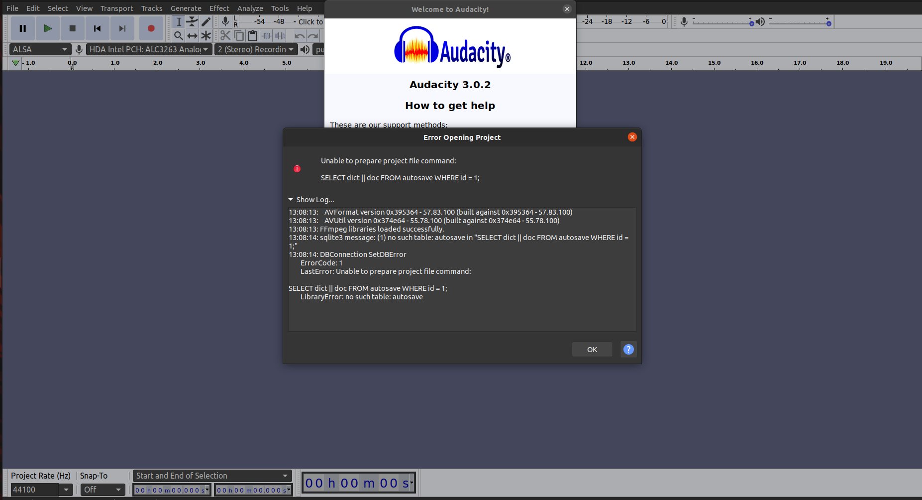

This is what comes up after following those instructions. Thanks again for all your help. Its much appreciated.
Going to delete the file now.
Thanks
C
As I think I said at the start, I was not very hopeful, but we tried ![]()
We’ve exhausted all the possible ways of recovery that I can think of.
