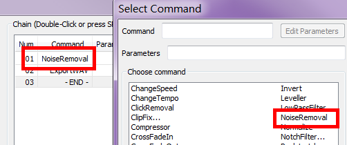

The really ugly place we would need to retain NoiseRemoval is in NoiseRemoval.h:
virtual wxString GetEffectIdentifier() {
      return wxString(wxT("NoiseRemoval"));
which is where Chains gets its identifier:

I assume we could do string replacement as we have done before when we changed Chain command names, but I still think the rename is misguided.

It is clearly confusing for the name of the effect to be called something other than the action choice.
