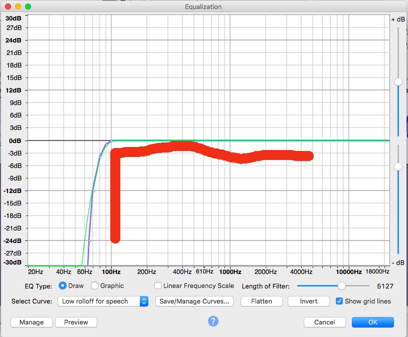

The “L” setting is really the high pass filter. Allow everything but the bass notes to go through. That’s it’s official name.
This is where that “L” comes from. It’s roughly the pattern the equalizer tools makes when it’s suppressing bass notes (thin green line). Click the graphic.

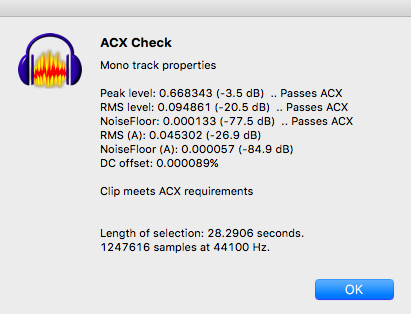

Your clip passes ACX perfectly, but I didn’t use the standard corrections. Instead of the first tool, Equalization, I substituted Effect > Notch Filter: 120Hz, Quality 2. Then RMS Normalize and Limiter.
Didn’t need noise reduction.

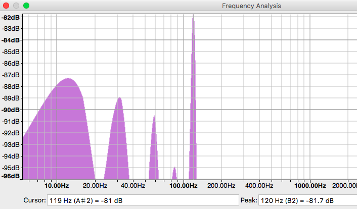

I selected a portion of background sound (not your voice) and used Analyze > Plot Spectrum. It’s pitch (frequency) along the bottom and loudness top to bottom. Click the graphic if it doesn’t fit on the screen.
There’s a big spike at 120Hz (read along the bottom) with shorter ones to the left. The only serious one is 120Hz. That one is clearly audible and its the loudest one. The tones to the left aren’t nearly as loud and they are tones such as thunder, earthquake and pipe organ bass notes. Easy to ignore.
