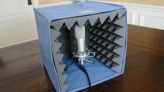

I know they’re not Auralex, and they’re “wedge” instead of pyramidally shaped, but they should suit my purpose, yes?
Also, I’ve heard that acoustic foam can be difficult to cut, but that an electric bread knife works really well. I can get a Black & Decker model at WallyWorld for $12.97. The Whitmor 14" collapsible cubes are cheap there, too.

The USP of the collapsible-cube design is portability.
A stool / chair / ironing-board / drying-rack (clothes-horse) / luggage-rack, etc, on a desk*,
with a quilt/duvet draped over it, would be as good as one of those cubes, (if not better), just less portable.
The advantage is you probably already own the items.
[ * a rug / doormat(s) would protect the desk from scratches, and absorb sound ].
If you have to buy that, the total-bill is about the same as a ready-made 12" cube, (which do sound boxey).

So. I built a micro-studio with the Whitmor 14" cubes and some Ultimate Acoustics foam. I do appreciate the concern re: my TBI. I don’t have much difficulty with my manual dexterity, but better safe than sorry, right? I bought a manual Farberware bread knife from WallyWorld for less than $5 and it worked fine, with the aid of my trusty GF. Having someone hold the far edge of the 24" foam when cutting across the ridges definitely helps. Electric knife is unopened/unused and will be returned this weekend.

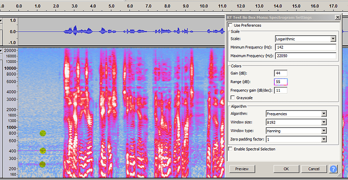

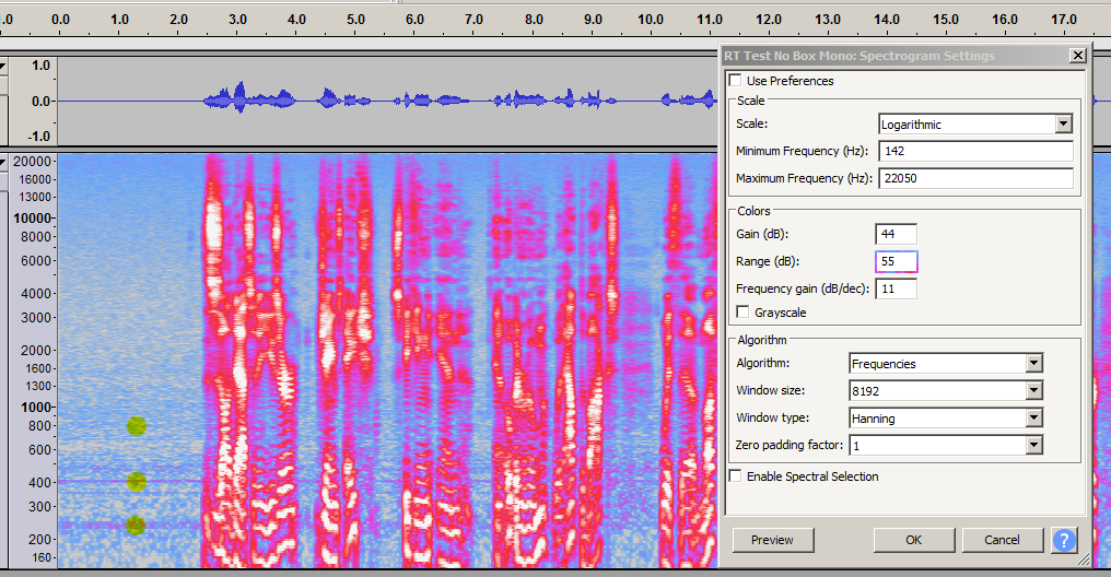

It’s visible on the spectrogram : particularly a constant ~400Hz tone …
The first two seconds of room tone show little or no change between the clips, and as Trebor above, there’s definitely a motor back there somewhere.
Even if the noise level didn’t dive inside the mini studio, I would expect to hear some change between the clips.

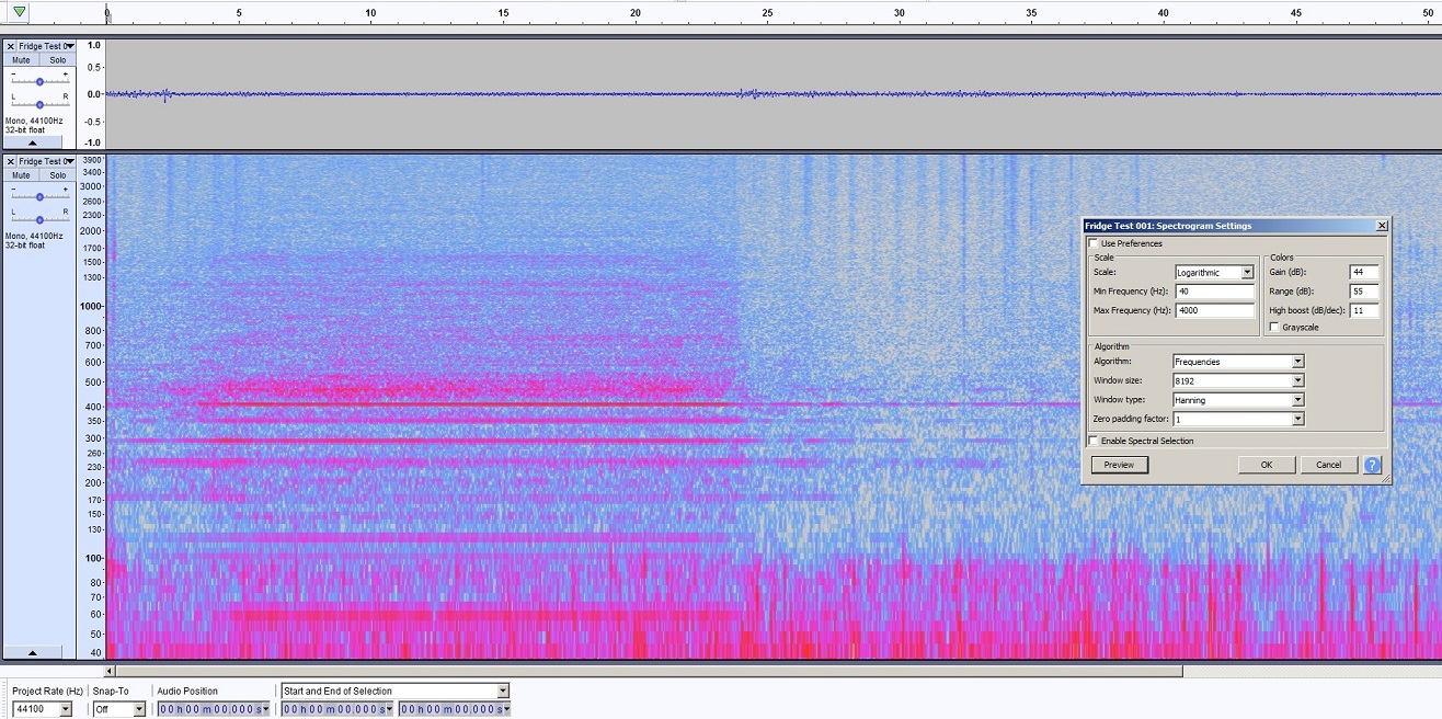

Found it. It was the fridge, just as I’d suspected. It’s in direct LOS of where I read from.
I folded up my tripod into a monopod, turned on the H4, and walked straight into the kitchen with the recorder pointed directly at the fridge. Recorded that for ~20 seconds, then turned around and walked back to my seat on the couch and turned the H4 back to its normal position.
Here’s the spectrogram: (Note that none of this noise has been present in my previous recordings, that I can tell.)
