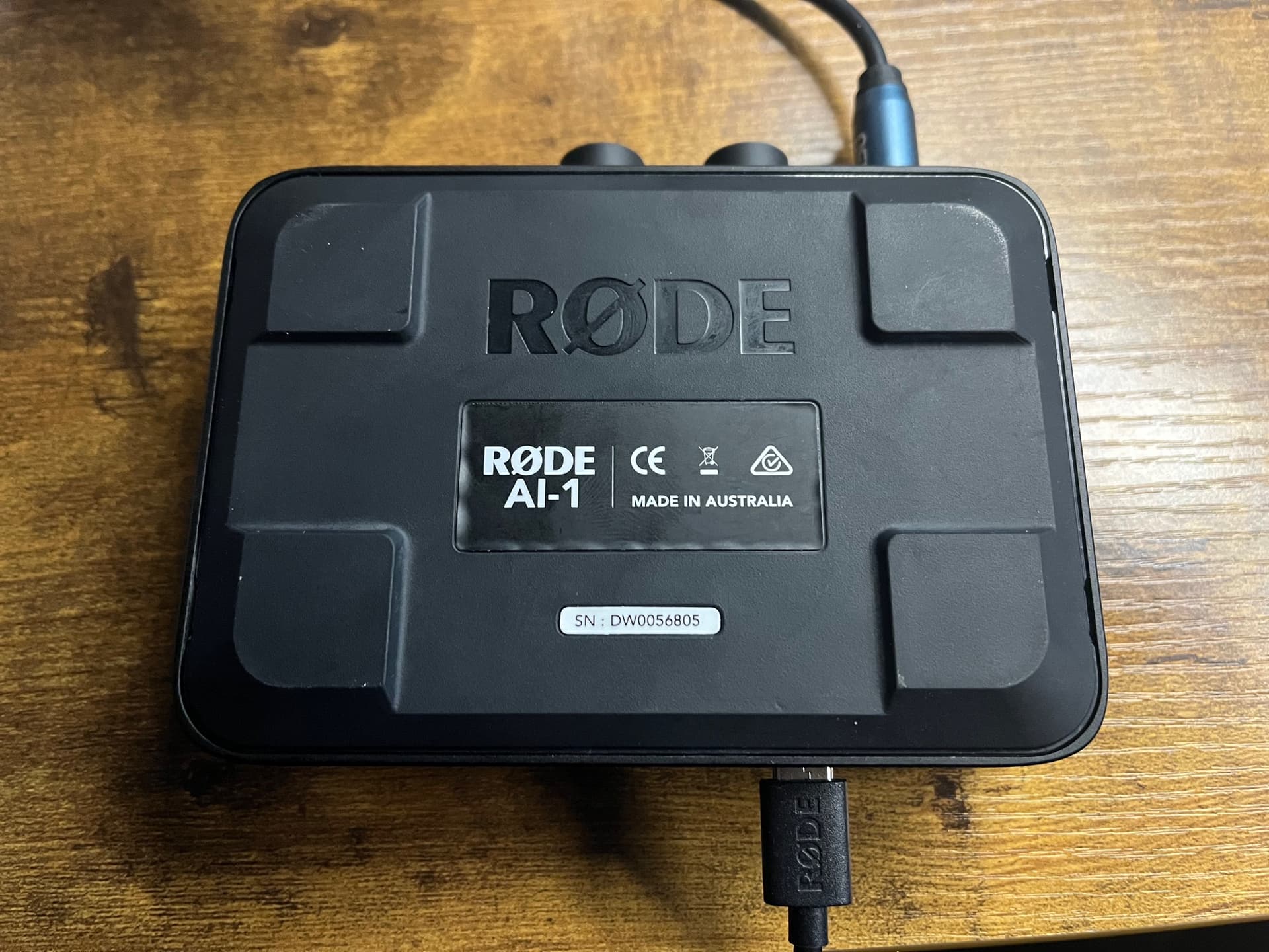

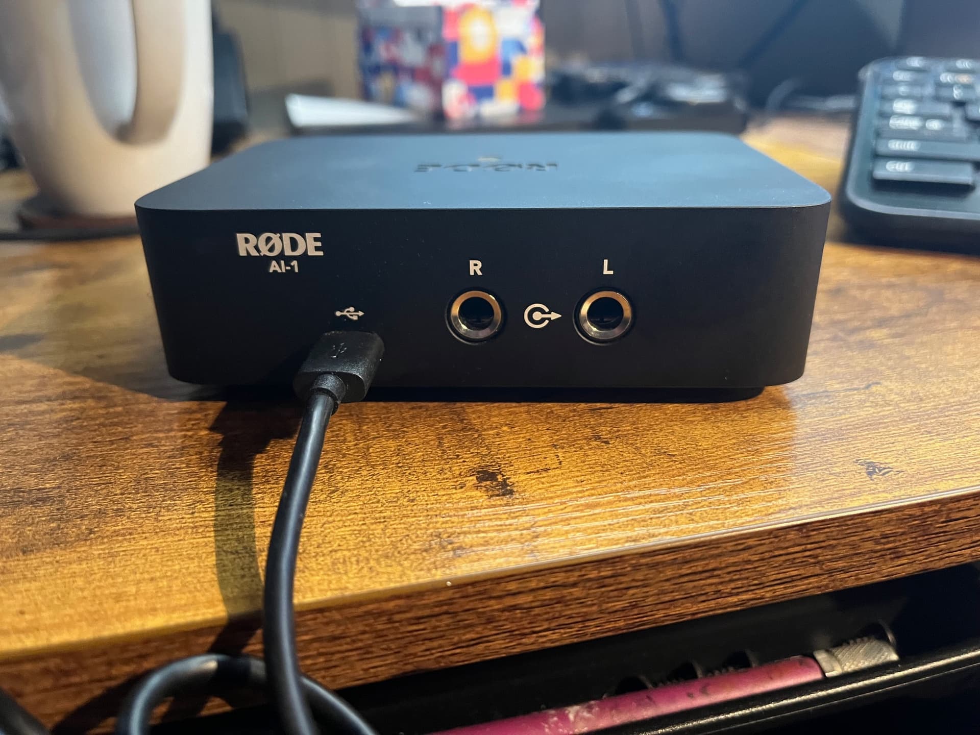

Hi Koz…so I took a shot of the AI-1 interface. Will send 2 others separately.

Thanks for the excellent pictures.

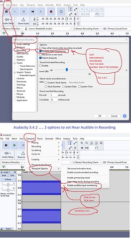

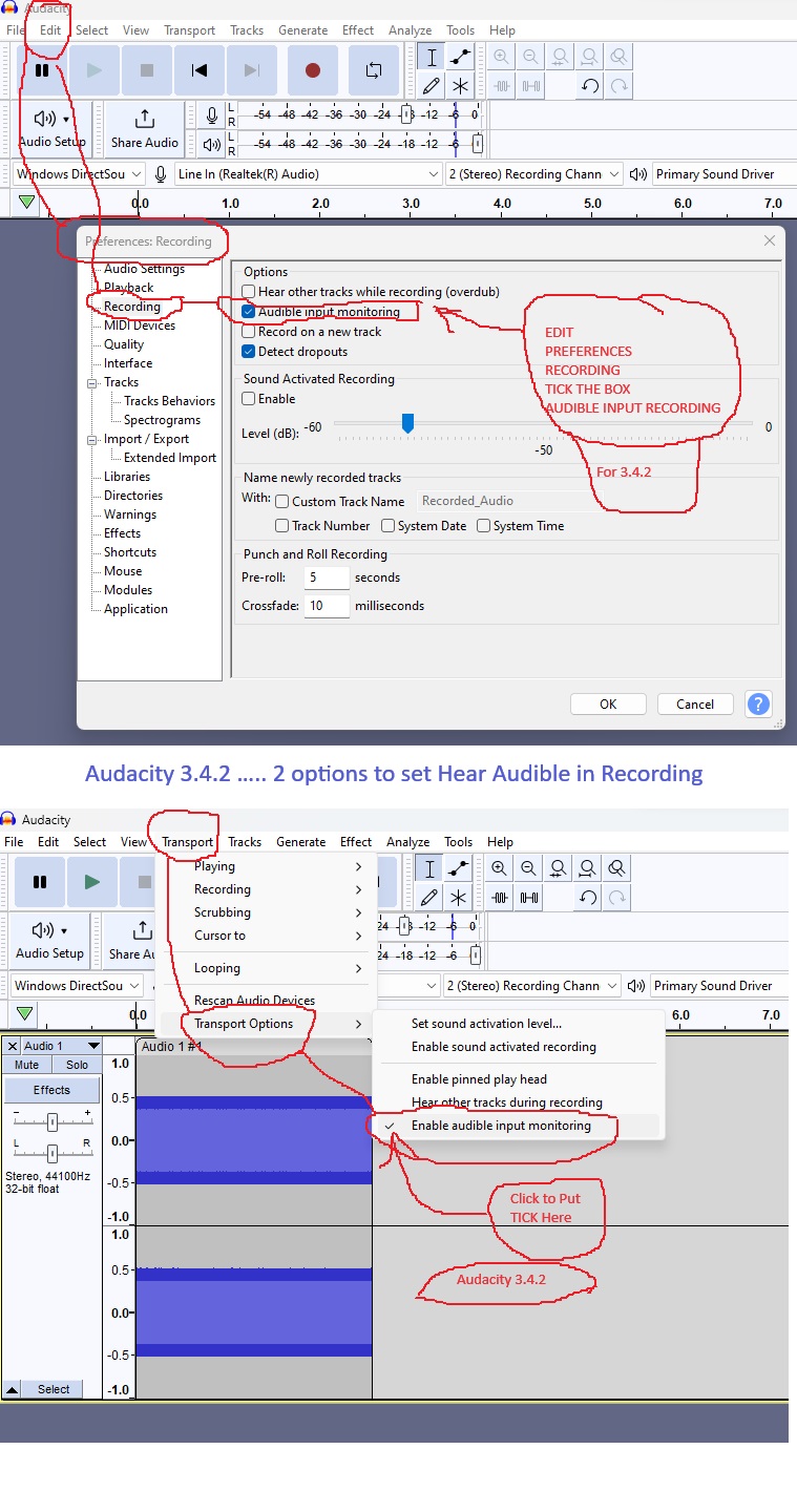

Yes, OK, that may be the case, I have updated for some time now to 3.4.2…The options on the screens are similar, But it was called “Software Passthrough” or similar back then… in any case there are 2 different ways of doing the same thing whether in 3.4.1 or 3.4.2…either from Edit, Preferences…Recording… OR from… Transport Options and click to tick… You Only Need To Do One or The Other…see screen dump attached… for 3.4.2.
