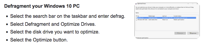

If you have a spinning metal drive (can you hear it spinning up? oooooeeeeeTICK) then you should make sure it doesn’t fill up and defragment and optimize it on occasion.
