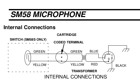

For anyone that is interested and to clear up any confusion, here is the internal wiring diagram for a Shure SM58.
Note that neither the capsule or the transformer are tied to ground, thus the voltage potential (signal strength) across pins 2 and 3 will be exactly the same whether one is tied to ground or not. The only things affecting the signal strength are the sound pressure level and the impedance across pins 2 and 3. If the transformer were centre tapped to ground then chris319 would be correct, but as can be seen, it isn’t.
Reference: http://www.shure.co.uk/support_download/downloads/user-guides/user-guides-microphones
