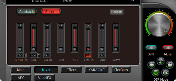

Here is a screenshot of my mixer panel:
Looking quickly at the STX manual you need to make sure that the mic source is deselected; press the button below the mic fader so that the red light is not lit.
Then activate the Line in channel by making sure the red button below the fader is lit.
Once that is done in Audacity you should be able to select the line in input mode; mine says "Line In (Asus Xonar D2 Audio Device).

That is the correct configuration within the Asus driver.
I suggest you now leave that fixed and concentrate on the Windows settings I mentioned above and possibly the recording source you are selecting in Audacity. BTW can you post a screenshot of the available recording options you see in Audacity?
