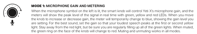

My Gain level is set to 6/11.
Where are the green and yellow lights when you announce?

As for the green and yellow lights, they reach up to the ninth dot.
Conveniently enough, the Yeti manual doesn’t tell me which lights are what color.
But they do tell me which colors are supposed to be lit. All the greens and an occasional yellow and no red. Is what what you have?
And just to fill in the gaps, since you have a Yeti in color and I don’t. The first 8 are green, 9, and 10 are yellow and 11 is red? Yell once to make them all light up to check. Yelling is not harmful to the microphone. Never, ever blow into a microphone. Blowing is a good way to create expensive trash.
