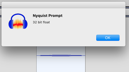

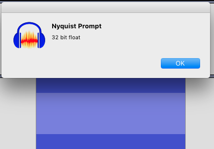

Confirmed, here the result of white noise at -24dB generated by Nyquist:
and at 0dB:

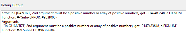

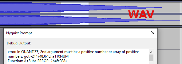

As can be seen from my previous post, have used this before, in version 2.3.1
However, in Audacity 2.4.2, I get this error:
Thinking it was an old syntax problem, changed the line:
(case (bit-depth s)
to:
(case (bit-depth track)
But the problem persists.
Any idea what is causing this?
TIA.

Same problem.

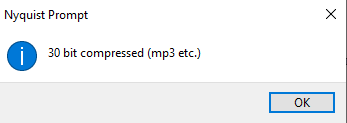

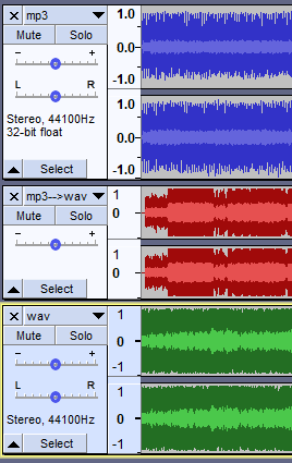

After some experimenting, here is something interesting:
The top most track, is an mp3, the plugin works and shows bit depth as 30.
The middle track, was originally an mp3 that was converted to wav, the plugin works and shows the bit depth
as 30, which is correct as the lost bits are gone forever and converting to wav is not going to bring them back.
Now the interesting one, it’s a wav (32 bit float) and was created from wav samples and was never converted to anything else.
In this situation, the plugin throws the above mentioned error.

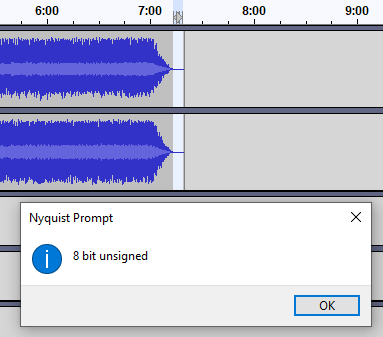

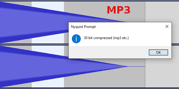

Another interesting thing, if the end part of the mp3 (where it fades to to almost nothing) is selected,
this is what is returned:
Is that normal due to the variable compression used by the mp3 codec?
It detects very little audio data and thus switches to the lowest possible bits?
That looks reasonable.
Could you make that file available to me so that I can check what’s going on?
I’m not an expert in the internals of MP3, but I’d guess it’s something like that, but I expect it’s more complicated.
I’ve just tested the tail end of an MP3 and it is showing “30 bits”.

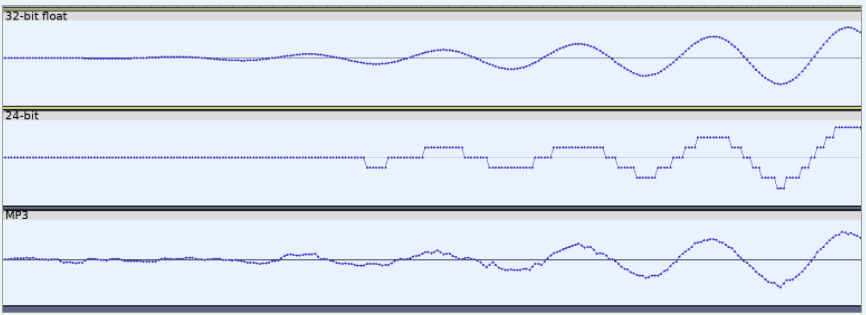

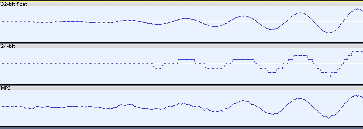

Just for interest, here’s a sine wave fading in from silence, and greatly magnified:
I unfortunately can’t supply the original wav file as it belongs to the studio, but I have attached another
wav (1 KHz tone, 0.99 amplitude, stereo, 32 bit float), that creates exactly the same error.
It has tone for the first 2.5 secs, then fades out by 3 secs, then has about 75 milliseconds of silence.
Also attached it as mp3 (320Kb/s CBR) and that is fine, shows 30 bits.
The silent part also returns 30 bits and not 8 bits as shown with the other mp3.
So, either there is a bug in Nyquist or the code or, the previous mp3 was malformed.
Very interesting, wonder what the harmonics generated by the 24 bit wav versus the mp3 would be like.
