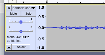

You said:
There’s a wave form, so I can see that it’s recording, but there’s no sound.
In engineering-speak, that means you have up and down wiggles in the blue waves.
If you have a straight, dead, flat blue line, that’s not “waveform,” that’s an engineering error.

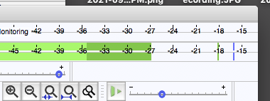

If you have a waveform (and a bouncing sound meter)
Those two are the gold standard for actually having a show whether or not you can hear it. The blue waves are good for indicating the loudest parts of the show and the bouncing sound meter …
…will tell us performance volumes for most of the natural range.
I have more than once certified a broadcast performance relying solely on my instruments and not being able to hear a thing. If the blue line is dead flat and the bouncing meter doesn’t bounce, then something is broken.

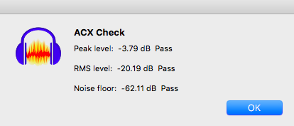

I opened your test and applied the Audacity Audiobook Mastering tools and produced a clip that passes ACX conformance, but not by a lot.

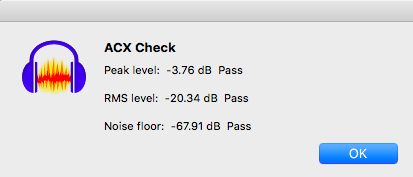

I applied very gentle “noise reduction of the beast” (6, 6, 6) and produced a submittable product.
So with the exception of your earphone problem, I think we may be done. There’s still theatrical patching depending on your personal preferences and whether or not ACX likes your breathing. There’s no test for that I know of.
