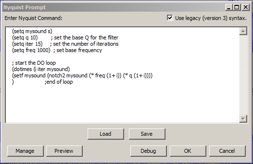

    (setq mysound s)
    (setq q 10)         ; set the base Q for the filter
    (setq iter 15)     ; set the number of iterations
    (setq freq 1000)  ; set base frequency
    ; start the DO loop
    (dotimes (i iter mysound)
    (setf mysound (notch2 mysound (* freq (1+ i)) (* q (1+ i))))
    )                     ;end of loop
Since all this hole-poking is happening right in the exact middle of the ear’s maximum sensitivity range (~1KHz to 4KHz) I would expect to be able to hear that filter working, further, this is a post-production solution and the poster’s applications include real-time tasks.
