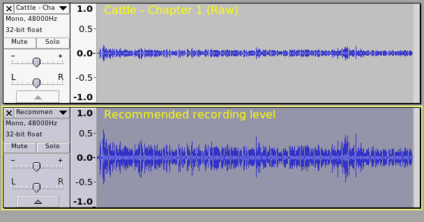

Yes, still a bit low.
The first track is your “raw” recording.
The second track shows what it would look like at the recommended recording level.

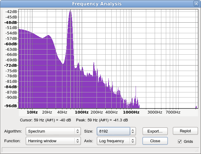

The remaining hum is mostly 60 Hz mains hum.
60 Hz is very low pitched, and is easily filtered out without affecting the voice.
The more damaging effect is if there are harmonics at 120, 180, 240 … Hz as these would overlap with voice frequencies.
This spectrum plot is from one of your unprocessed (raw) silences. You can see that there is a large spike at 60 Hz (reported as 59 Hz), but thankfully no big spikes beyond that.

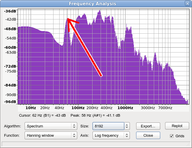

This is the same 60 Hz spike when analyzing the the whole track (voice and silence):

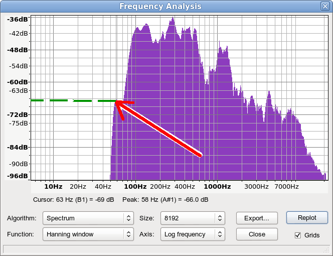

and here again, but at an almost insignificant level, after applying the “LF rolloff for speech” Equalization:
(It could be reduced further using the “Notch Filter”, but I don’t think it needs it if you are using the “LF rolloff” and a little “Noise Removal”.)
