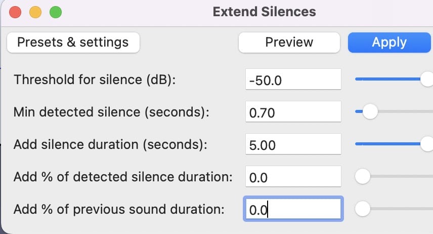

I add my voice to all those who appreciate the ExtendSilences plug-in. However, I have repeatedly hit against limitations with it and thought I’d post those here:
  1. If the audio being extended is over 60 minutes running the plug-in doesn’t work. No change is caused to the file. But if I split that same audio into 2 pieces each under 60 minutes, it works fine on each of the pieces (although it takes about a minute). I then combine those pieces.
Here are the typical settings I use when the above happens:
and here is a screen recording of it failing:
ExtendSilenceFail
Notice that when it fails, it only takes about 20 seconds rather than the minute or so for a 60min audio.
  1. I also frequently am limited by the maximum of 10s in “Add silence duration” and 100% in “Add % of previous sound duration” Why not allow larger values, say, 60s and 500%?
I’ve looked through the code and it looks like (2) might not be too difficult to change, but I’d have no idea how to deal with (1). Anyway, .ny code is a great mystery to me and I haven’t been brave enough to try editing. But I would if guided by expert tips.
Thanks
Unfortunately that is a known limitation for this kind of plug-in. Because it is a two pass effect (the track must first be analyzed, and then processed), the selected audio has to be held in RAM (Nyquist can only read the track once), and Nyquist is limited to about 2GB RAM. It’s getting on towards a decade since I wrote this plug-in, and this limitation still exists, so I doubt that the limitation will be removed any time soon.
I posted a comment earlier in this topic about how to modify the input ranges. See the posts dated “Sept '17”.
