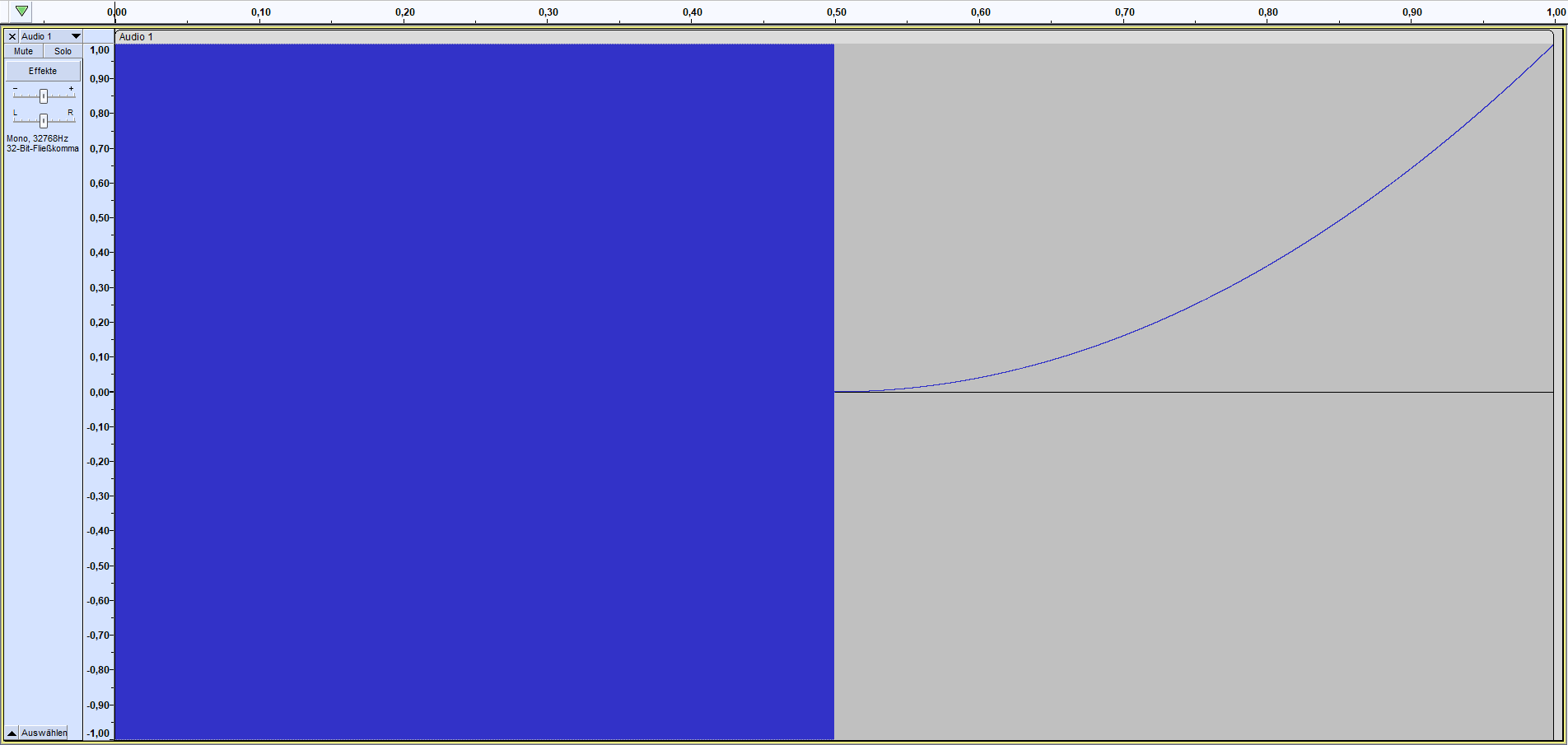

Cool, I thought, converting it into LISP as: (power (- 1) (round(- (* 2 x) 0.5))), plotting from -1≤x<1, with a lenght of 1s/128 and uuh…
It returns a track, with every sample, seemingly at +INF. I assume, that’s because the track is in ‘32-Bit float’, with the datatype ‘float’, being infamous for having ±INF values, which are often unchangable by definition (I’ve btw figured out a half-solution to this, by changing the track’s format to any PCM one, setting every sample to ~0, just after starting to write this). Now, this seems to be, because of 2 problems. The first being, that the ‘power’ function is kinda messed up, maybe? I don’t want to slam down wrong statements, here, but the function seems to fail to plot something as simple as x² (power x 2), over -1≤x<1

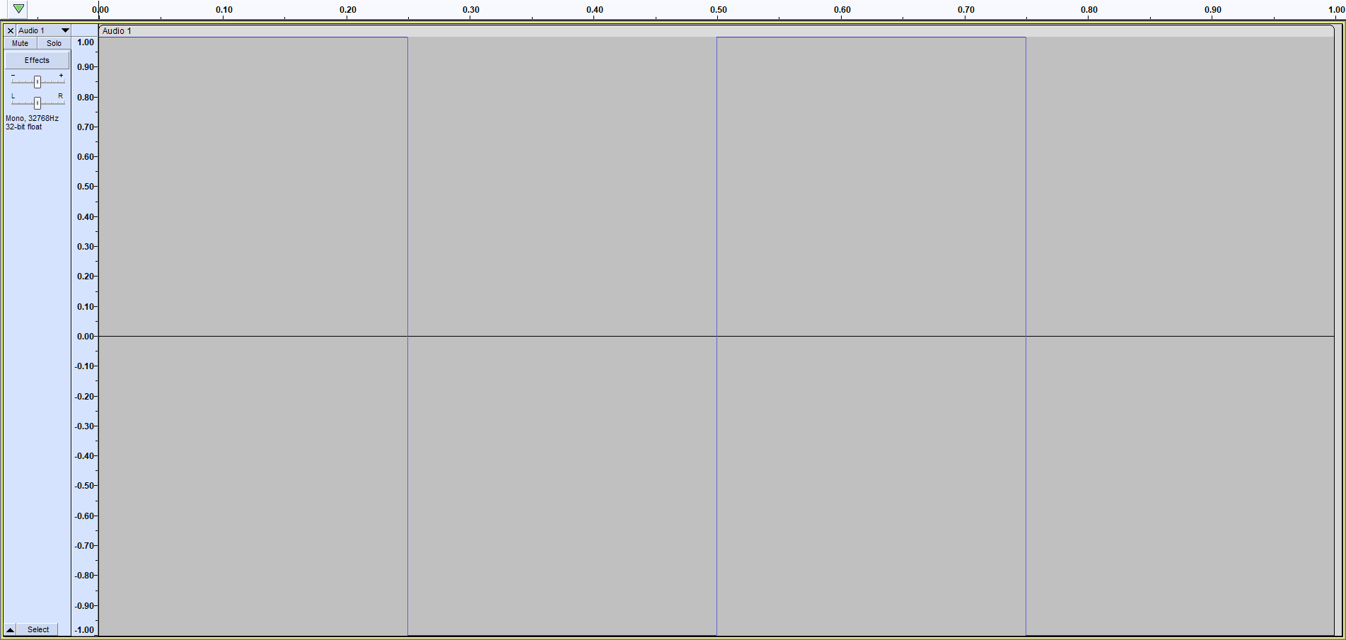

So, finally, we can write (expt -1 (floor(* 2 x))); -1≤x<1, press ‘Generate’ and…
It doesn’t generate anything, once again. *Sigh. At this point, I was kinda on an emotional rollercoaster.
Eventually, I’ve figured it out (I think). Apparently the first argument must(?) contain ‘x’ for some reason,
so trying out something as stupid as (expt (- (* 0 x) 1) (floor(* 2 x))) instead:
Uhm… okay. So there, we have it: a LISP expression, for easily making square waves:
(expt (- (* 0 x) 1) (floor(* a x))); a ∈ ℝ; a = amount of cycles; -1≤x<1 (don’t forget to add the floor function)
Keep in mind, that this doesn’t account for phase, so you’d have to figure that out, on your own.
I know, this is a forum, but in case, you’re curious, what I’m doing with this: Try: (/ (+ (expt (- (* 0 x) 1) (floor(* 50 x))) (expt (- (* 0 x) 1) (floor(* -63 x))) (expt (- (* 0 x) 1) (floor(* -75 x)))) 3); Values of X from = -1; Values of X to = 1; Length of output = 0.390625, for example.
