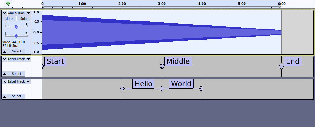

To get label data with Nyquist, use the “GetInfo:” scripting (Macro) command.
(Scripting Reference - Audacity Manual)
Try this in the Nyquist Prompt:
;type tool
(setf label-data (aud-do-command "GetInfo:" :type "Labels" :format "LISP"))
(format nil "~a" label-data)
If the project contains label tracks, you will see a list printed.
The first item in the list is a list containing the label data. The second (final) element is “T”.
Because “label-data” is a Lisp list, you can access the first element with (first label-data)
Example:
;type tool
(format nil "~a" (first label-data))
Returns:
((1
((0 0 "Start")
(180 180 "Middle")
(360 360 "End")))
(2
((120 180 "Hello")
(180 240 "World"))))
Notice that the first item in this list is the first label track, and the second item is the second label track.
To get the label data for the second label track, you could use:
(second (first label-data))
which gives the list:
(2 ((120 180 “Hello”) (180 240 “World”)))
where the first item is the track index (zero indexed, so “2” = third track)
and the second item is the labels:
(list 120 180 “Hello”)
and
(list 180 240 “World”)
