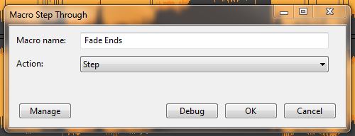

A new version of “Macro Step Through”.
Unfortunately it still has the same limitation as described in my previous post (Nyquist effects don’t run), but it has some additional “Actions”.
  • Step: This is the normal step-through mode. Performs one step of a macro.
    Each time this runs it automatically moves onto the next command in the macro.
  • Restart: Resets and runs the first step of the macro.
    You would normally run this once only and then change to the normal “Step” action.
  • Skip Step: Skips one command step and runs the next one.
  • Repeat Step: Runs the last step again.
  • Run All: Runs the entire macro from start to end.
    (as always, any Nyquist effects in the macro fail silently)
  • Reset: Reset (only).
Note that as with all Nyquist effects, it defaults to the last selected settings, so, for example, if you run “Action: Reset”, then repeating “Macro Step Trough” will simply reset again. To go back to stepping through a macro you need to run it with the GUI and select “Action: Step”.
MacroStepThrough.ny (2.31 KB)
Feedback and bug reports welcome.

The available GUI options for Nyquist plug-ins are quite limited.
The interface is created on the fly by Audacity before the Nyquist code runs.
The plug-in code only knows which line of the file it is on when the code runs.
so it is not possible for the plug-in code to modify the GUI in any way.
Something that I’d like to see in the future is the ability for the plug-in code to define the GUI. On launching a Nyquist effect, part of the Nyquist code runs first to create the GUI, then on clicking “OK” the effect itself runs. We don’t have this yet.
Possible solution - I could print the line number to the debug output.
The debug output is visible in one of two ways:
  1. Run the effect with the “Debug” button (rather than the “OK” button).
  2. Run the effect with the “OK” button and look in the Audacity log window.
I expect that the Audacity log window would normally be preferable as you can open it (from “Help menu > Diagnostics > Show Log”) and leave it open while using Audacity.

Looks straightforward, and I can probably add some other useful information there as well.
Here’s a new version to try.
As I wrote previously, you can either run with the “Debug” button, or open the Audacity log to view additional information.
MacroStepThrough.ny (3.23 KB)
