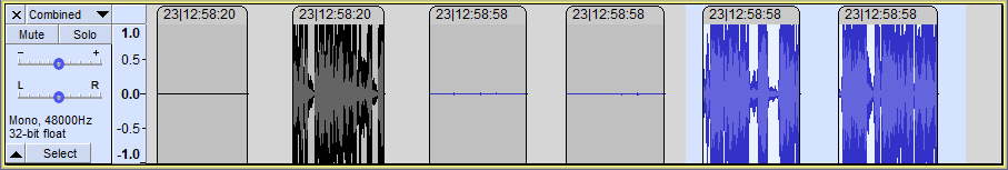

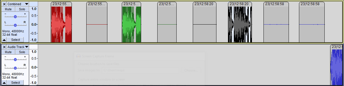

One issue that puzzles me is that your AUP file named only 1211 block files, yet the _data directory contains 2375 block files (about double). Also, about the half of these latter looked to be all zeros but when I amplfied them by 45-50X I found (noisy) conversational audio.
Anyway, I am continuing my efforts… remember, koz has told us about the baskets and the musical matching. ![]()
This may prove to be an issue. There were certainly many (not excessive) envelope control points that we’ll probably need to skip.
