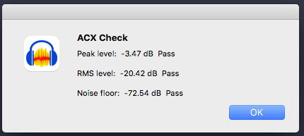

After you apply Mastering, you can check your work with Analyze > Steve Daulton > ACX-Check.
-Screen Shot 2024-08-01 at 12.23.03 PM
That’s from the last sample, not the current one.
Peaks have to be quieter than -3dB, RMS (Loudness) needs to hit between -18dB and -23dB and noise has to be quieter than -60dB.

It does pass Mastering.
