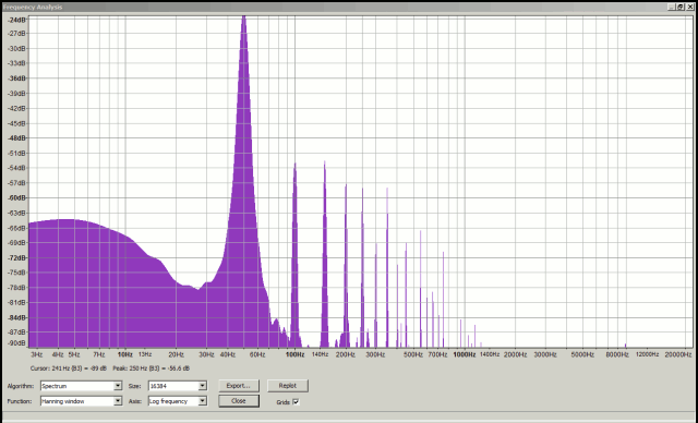

Ok so the pluggable usb hub came in the post today and it has got rid of the high pitched humming which is great but now I get a low pitched hum. I’ve tried different usb ports but its the same each time. I have attached a sample.
That’s got some 1KHz harmonics from the computer and now has added 50Hz harmonics (mains hum) …
I’d be tempted to try a decoupling capacitor, (aka bypass capacitor), across the 5V power supply coming from the USB socket,
